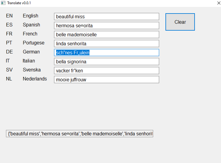

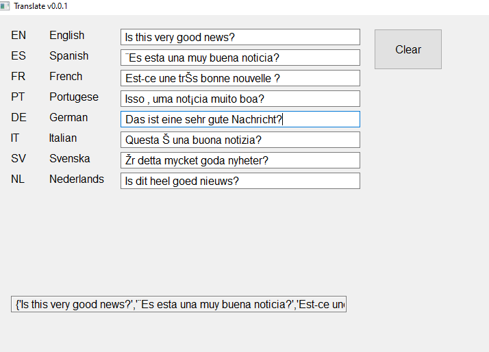

Post
by serge_girard »
Jimmy,
Take a look at attached screenshots ! (sch”nes Fr„ulein: I had to be creative in order to find a nice German example !)
How can I solve this?
- g72.png (19.65 KiB) Viewed 4763 times
- g7.png (21.62 KiB) Viewed 4763 times

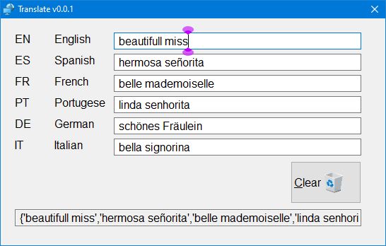

by AUGE_OHR »
i Serge,
please use "my" Sample which work correct
- beautifull.jpg (33.25 KiB) Viewed 4760 times
p.s. i have enter "beautifull miss" to get "schönes Fräulein"

by serge_girard »
Ha! This works well...!
I compiled with hmg 3.0.44...
Which do you use?

by AUGE_OHR »
hi Serge,
serge_girard wrote: ↑Thu Apr 06, 2023 11:44 am
Which do you use?
c:\hmg.3.4.4
UNICODE
