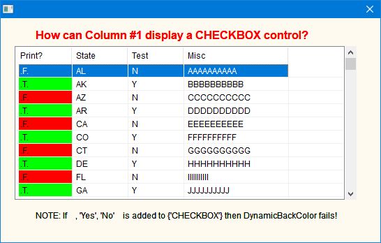

Hi All,
Thank you all for you kind suggestions.
I made two discoveries about the ColumnControl for Column #1.
1) If ColumnControls[1] is {"CHECKBOX, "Yes", "No"} then my DynamicBackColor is not correct.
The part of DynamicBackColor that uses Column #1's Value Fails.
It should display a Column #1 .T. (value) row in GREEN.
I can successfully use {"CHECKBOX"} but still no CheckBox control appears.
2) Also, when this (Fails) happens I cannot programmatically read or update Column #1's Value.
llThisCellVal := GetProperty( "DataBrowse", "BrowseStates", "CellEx", lnGridRowNr, 1 ) // Always returns Nil!
Until today I did not know what was causing this incorrect Nil value "bug".
Mol: A ColumnControls[1] Value of NIL displays just the same as {"CHECKBOX"}. No CheckBox appears.

Red2
Posts: 282
Re: CheckBox in a Grid Problem
Post by Red2 »
Hi Everyone,
Thank you all for your kind suggestions and advice!
In the attached .ZIP file is my example code.
1) It uses HMG's IDE
2) It creates the sample .DBF file that the Grid displays.
3) Column #1 of the Grid, displays the Logical field, By_State->MergeState
4) The Grid's COLUMNCONTROLS array is generated in function DataBrowse_OnInit()
I REALLY appreciate everyone's ideas and guidance.
Thanks again,
Red2
Example_14-August.ZIP
(3.93 KiB) Downloaded 126 times

Red2
Posts: 282
Post by Red2 »
Hi JImmy,
Thank you for your kind suggestion. I appreciate it.
More Information:
My display originally used a Browse Control.
I changed it to a Grid Control so Column #1 would display a CheckBox.
For my needs a Grid works OK because no rows will ever be added or deleted.
I want the user to interact with Column #1 using a CheckBox.
The HMG sample C:\HMG.3.4.4\Samples\Controls\Grid\Grid_CheckBoxes\Demo.PRG is appropriate:
Unfortunately I have been not been able to make this happen using:
1) The HMG IDE and
2) Displaying a .DBF table instead of a data Array.
I am still looking for a successful result.
Thank you again for your expert guidance.
