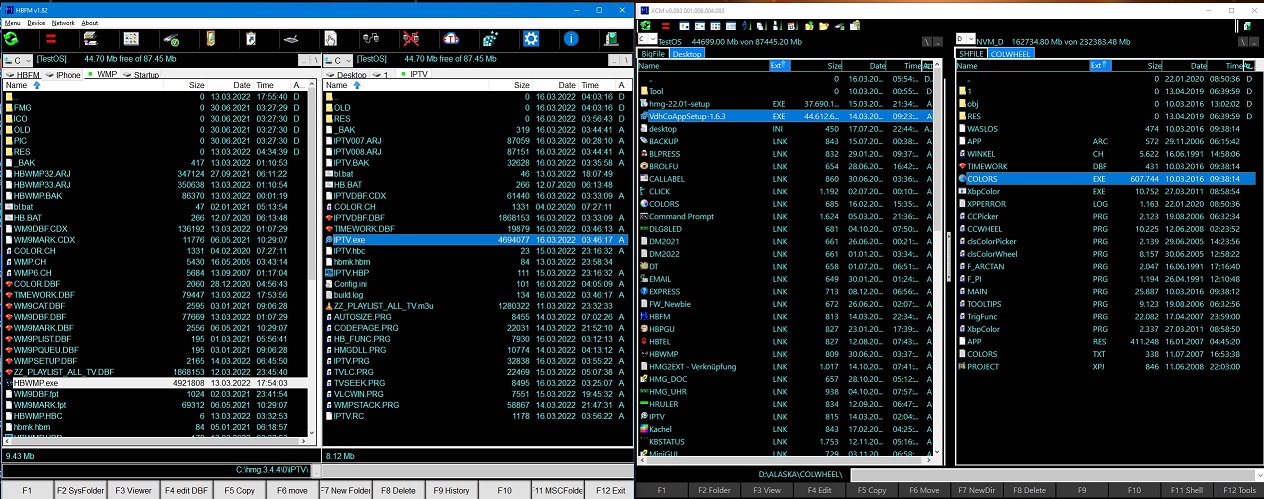

hi Mol,
it is "by Design" of Windows that "active" Color switch when "lost Focus"
open 2 x Explorer Windows and use "Detail" for "Report" Design -> GRID / BROWSE
now switch Windows and note "hi-light" or "low-light" Row in Explorer
on left Side it is a HMG App and on right Side my Xbase++ App
left Side have Focus (see active Titlebar) but only 1 GRID are "active"
my Xbase++ App use "own" WC_LISTVIEW Control and "Owner Draw"
both GRID have "hilight" ROW even Window / Control are not active
so you need "Owner Draw" to get that "Look"
