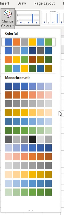

That is so kind of you Grigory! I thought to create such a header file later. But, you created and helped a lot! Thanks a lot.
I have used the same colors and themes as in Office 365. That is why problem with naming.
I hereby give the screenshots of MS Excel from where I have taken the colors. Hope it is useful!
For monochrome themes they have used the same colors as above.
Again, thanks for your interest!

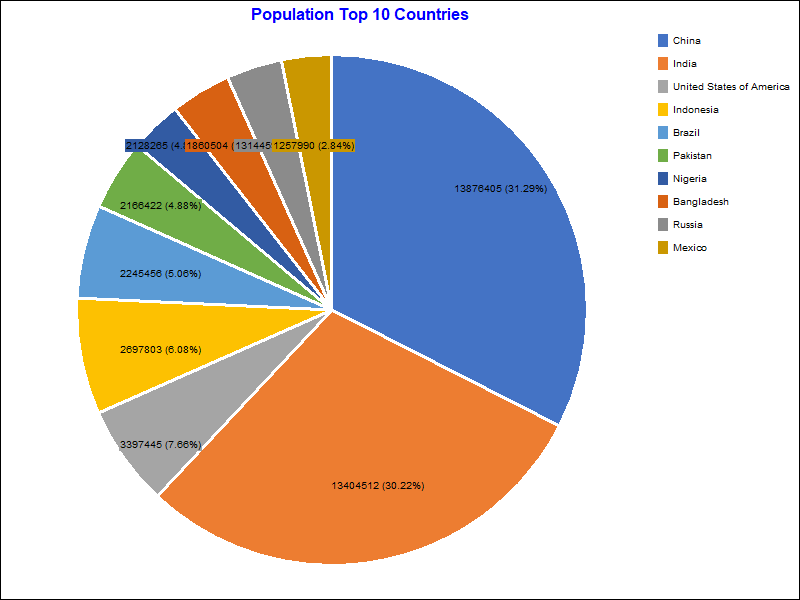

Hi Rathi,
I've added also the following modifications:
- fixed the values percent calculation in the Pie graph;
- updated the centering of a graph title taking into account
the width of the legend at right;
- added the legend's centering in a bottom position.
My results and updated source are attached.

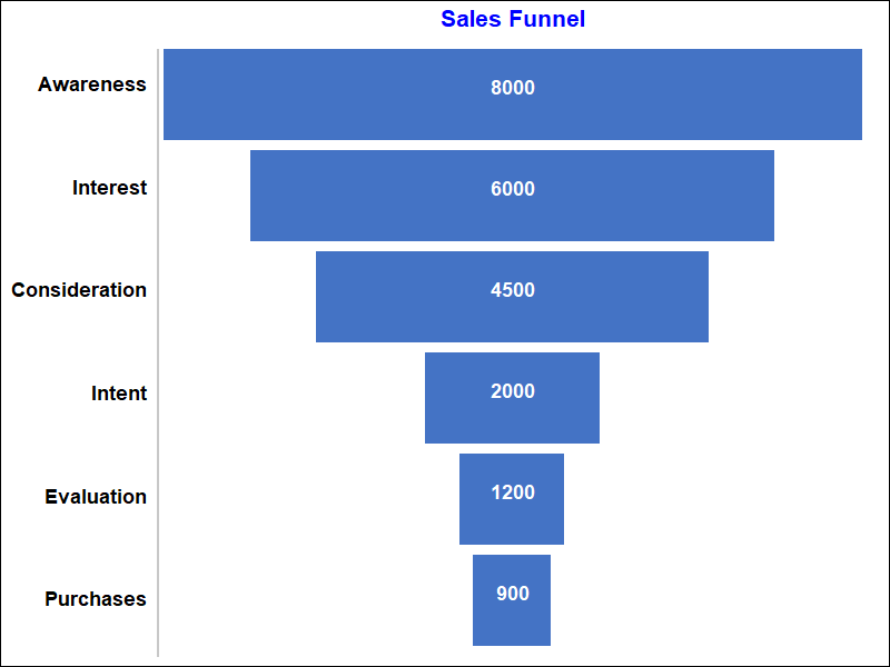

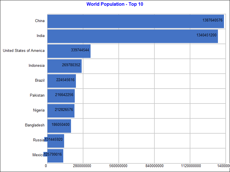

Re: GraphPlus
Posted: Thu Jun 03, 2021 4:16 pm
Thank you Grigory. Merged your code.
Added the following features:
- New Graph Type Bar
- New Graph Type Funnel
- Pie Chart in clockwise (Previous pie chart was drawn in anti-clockwise which was awkward)
- Fixed many bugs and inefficient code
GraphPlus_2021_06_03.zip
(11.63 KiB) Downloaded 333 times
