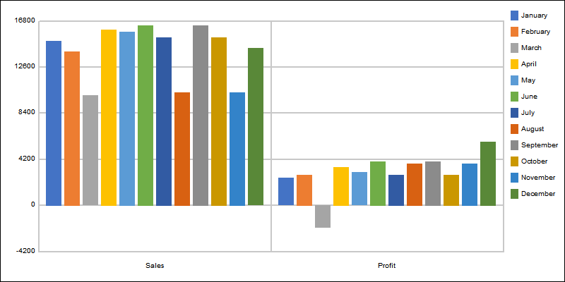

Hi Rathi
Thanks for GraphPlus.
Just one suggestion. When we swith rows and colums the legend 'period' goes to y-axis.
I think it should remain on x-axis. Below 'Sales' and 'Profit' figure.

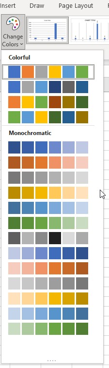

That is so kind of you Grigory! I thought to create such a header file later. But, you created and helped a lot! Thanks a lot.
I have used the same colors and themes as in Office 365. That is why problem with naming.
I hereby give the screenshots of MS Excel from where I have taken the colors. Hope it is useful!
For monochrome themes they have used the same colors as above.
Again, thanks for your interest!

Thanks a lot! Yes you are correct! Actually, it is meaningless to add the title there. So, I have removed the titles. If required, we can add manually before drawing!

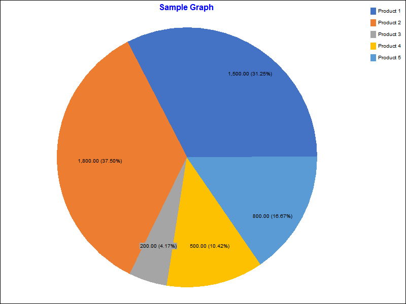

I've added also the following modifications:
- fixed the values percent calculation in the Pie graph;
- updated the centering of a graph title taking into account
the width of the legend at right;
- added the legend's centering in a bottom position.
My results and updated source are attached.

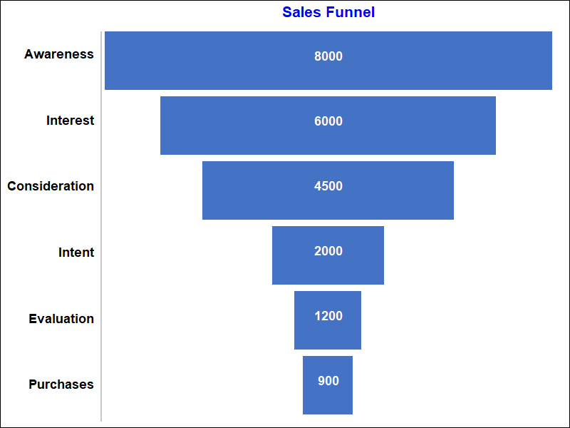

Added the following features:
- New Graph Type Bar
- New Graph Type Funnel
- Pie Chart in clockwise (Previous pie chart was drawn in anti-clockwise which was awkward)
- Fixed many bugs and inefficient code

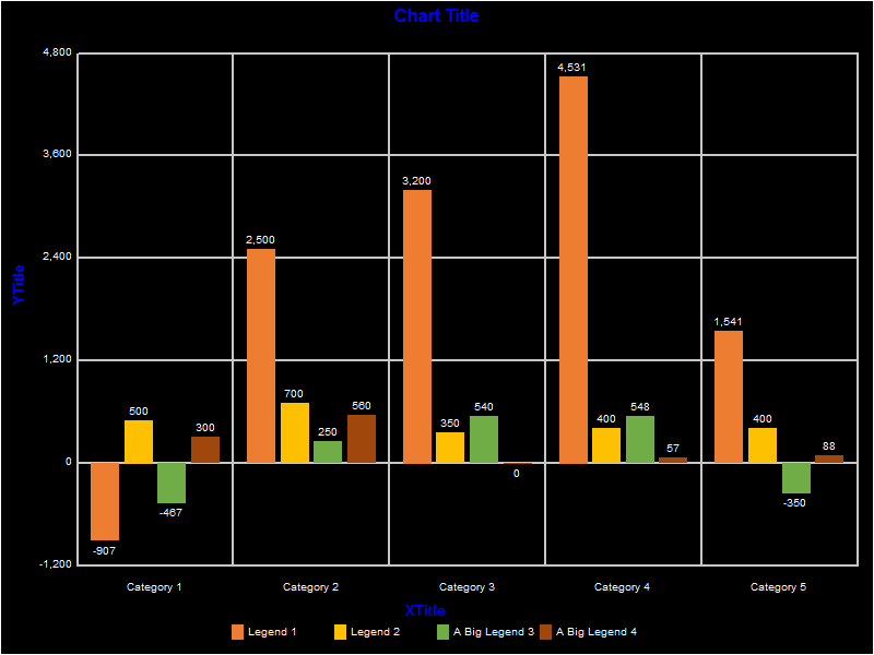

Hi Rathi,
Thanks a lot :!:
Please take a look for my small corrections:
- fixed warnings at compiling with the Harbour switch -w2;
- swapped output order for legends and title for calculate the correct :nLegendWidth size;
- updated color definition of the YELLOW color in the header file GraphPlus.ch.
