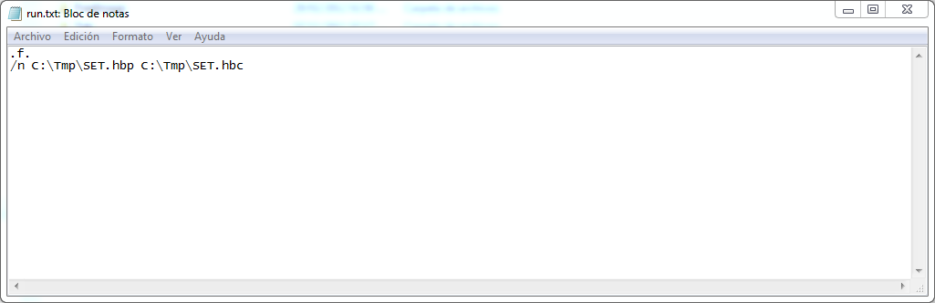

Examinador de Proyecto [SET.png (13.87 KiB) Viewed 7276 times
build.bat receives the parameters correctly.
was added a few lines in Build.bat
rem PROCESS PARAMETERS
rem
rem	/n	no run after build
rem	/d	enabled debugger
rem	/c	console mode
rem
	if "%1"=="/n" set runafterbuild=.f.
	if "%1"=="/n" shift
	if "%1"=="/d" set gtdrivers=-gtwin -gtgui
	if "%1"=="/d" set debug=-b
	if "%1"=="/d" echo options norunatstartup > init.cld
	if "%1"=="/d" shift
	if "%1"=="/c" set gtdrivers=-gtwin -gtgui
	if "%1"=="/c" shift
echo %runafterbuild% >run.txt
echo %*  >>run.txt
run.txt this file is generated in the application folder
I'm looking at where failure build.bat
