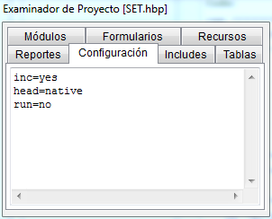

I use the IDE
I'm tryng to modify build.bat (hmg 3.0.40) to obtain:
1- no outorun after build
2- to copy the executable file in another folder and run the executable from that location but...
The first parameter passed to build.bat is always /n even if I put in ide configuration tab the run=no | yes

vierirom
Posts: 22
Joined: Sat Aug 20, 2011 3:49 pm
Location: Rome, Italy
Re: HMG Beginner
Post by vierirom »
Hi danielMaximiliano.
Thank you for the replay.
Looking at "mybuild.bat", you sent me, seems that i have to call this file from OUTSIDE of the hmg IDE.
Isn't it ?
I'm asking about the possibility to change the behaviour of build.bat but leaving the functionality of "Build & run" command from IDE.
The HMG IDE calls the Build.bat, but Run the executable in any case ... (even if the last lines of build.bat are comment out) Why ?
The tooltip of the configuration tab of IDE shows :
gui|mt|picshared|nulrdd|nodefgt|debug|opt|map|strip|hbcppmm|winuni|implib|run|inc=[yess|no]
If you see, of the many choices mutually exclusive, there is also a "run=no" among many possibilities but seems don't working.
Thank You.
Vieri
Examinador de Proyecto [SET.png (13.87 KiB) Viewed 7272 times
build.bat receives the parameters correctly.
was added a few lines in Build.bat
rem PROCESS PARAMETERS
rem
rem	/n	no run after build
rem	/d	enabled debugger
rem	/c	console mode
rem
	if "%1"=="/n" set runafterbuild=.f.
	if "%1"=="/n" shift
	if "%1"=="/d" set gtdrivers=-gtwin -gtgui
	if "%1"=="/d" set debug=-b
	if "%1"=="/d" echo options norunatstartup > init.cld
	if "%1"=="/d" shift
	if "%1"=="/c" set gtdrivers=-gtwin -gtgui
	if "%1"=="/c" shift
echo %runafterbuild% >run.txt
echo %*  >>run.txt
run.txt this file is generated in the application folder
I'm looking at where failure build.bat
