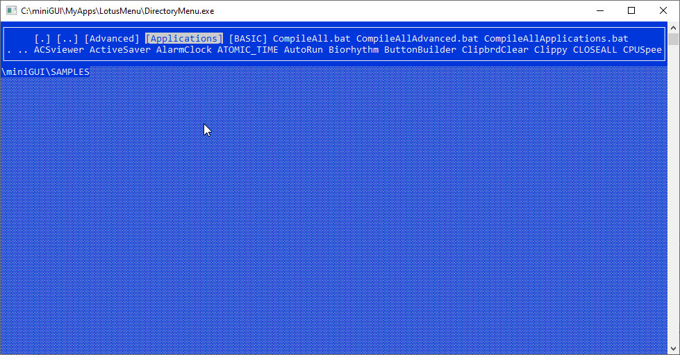

Update, 11/01/2021
Tweaked the interface for ESC key handling.
We now have a basic, no-frills horizontal folder navigator.
We'll do some cleanup ; add some comments ; and add some features with buttons or hot keys or some other trigger object we haven't thought of yet.
Thanks everyone for the suggestions, and for the assistance with some of the functions I asked about.

- Horizontal_Menu_Directory_Navigator_20211101.jpg (411.2 KiB) Viewed 715 times
