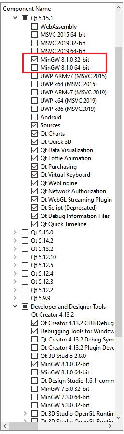

i just want to ask why MinGW v9.x :?:
it is only while QT Lib are for MinGW v8.1 not for v9.x
Re: HMG 3.5
what i mean : if i change MinGW Version i must have all LIBs made with that Version, or :?:

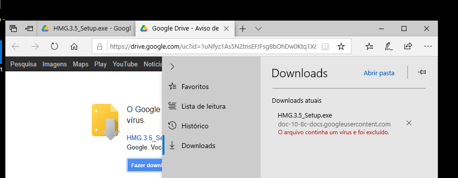

Captura de tela de 2020-11-15 16-27-52.png (44.66 KiB) Viewed 20127 times
Windows 10 deletando o arquivo.
Win-10 Delete a File

AUGE_OHR wrote: Sun Nov 15, 2020 6:02 pm hi,
thx for new Version v3.5
If you ask why MingW v9.x, because that is been recommended here.
Re: HMG 3.5
AUGE_OHR wrote: Sun Nov 15, 2020 6:44 pm what i mean : if i change MinGW Version i must have all LIBs made with that Version, or :?:
Yes. I think that will be better.

susviela wrote: Sun Nov 15, 2020 7:33 pm Captura de tela de 2020-11-15 16-27-52.png
Mine is also Win10. Does anybody else have the same problem?
