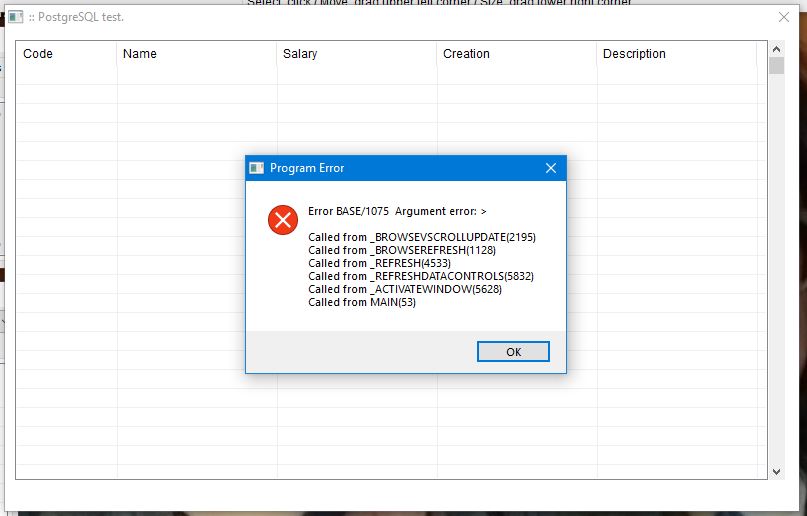

But, nothing it´s perfect. Take a look to the Browse control....YES, it don´t has Vertical scrollbar.
When you set VScrollBar to .T. it happens this runtime error...
This error it´s related to this function in h_browse.prg:
Procedure _BrowseVscrollUpdate (i)
Local ActualRecord , RecordCount , KeyCount
	// If vertical scrollbar is used it must be updated
	If _HMG_SYSDATA [  5 ] [i] != 0
		KeyCount := OrdKeyCount()
		If KeyCount > 0
			ActualRecord := OrdKeyNo()
			RecordCount := KeyCount
		Else
			ActualRecord := RecNo()
			RecordCount := RecCount()
		EndIf
		_HMG_SYSDATA [ 37 ] [i] := RecordCount
		If RecordCount < 100
			SetScrollRange (_HMG_SYSDATA [  5 ] [i] , 2 , 1 , RecordCount , .t. )
			SetScrollPos ( _HMG_SYSDATA [  5 ] [i] , 2 , ActualRecord , .T. )
		Else
			SetScrollRange (_HMG_SYSDATA [  5 ] [i] , 2 , 1 , 100 , .t. )
			SetScrollPos ( _HMG_SYSDATA [  5 ] [i] , 2 , Int ( ActualRecord * 100 / RecordCount ) , .T. )
		EndIf
	EndIf

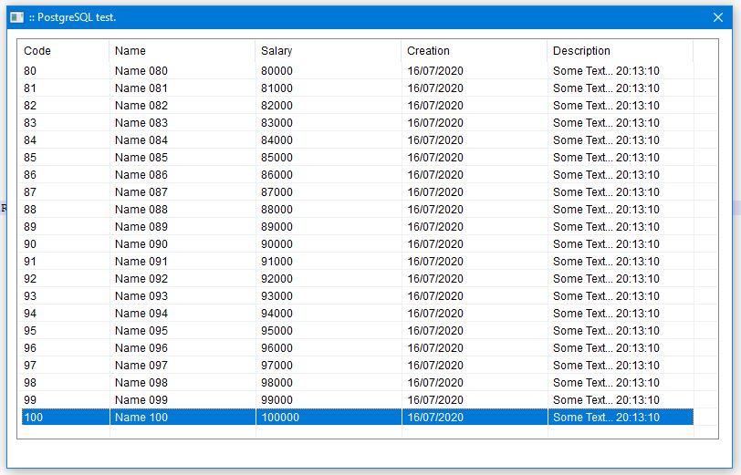

jairpinho wrote: Thu Jul 16, 2020 11:03 pm hello follows a functional example tested with postgresql-9.1.1-1-windows version, install and set password 123456
Thank you very much for your help. I´ll try your sample.
Best regards,
Salamandra, Brazil
Re: PostgreSql Libs not ready yet ?
thx for your Tip.
   for nPos:=1 to len(aTable)
      doMethod("Main", "Grid_1", "ADDITEM", aTable[nPos])
to transfer Result-Set into Array is the normal way

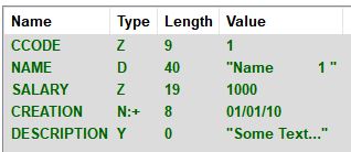

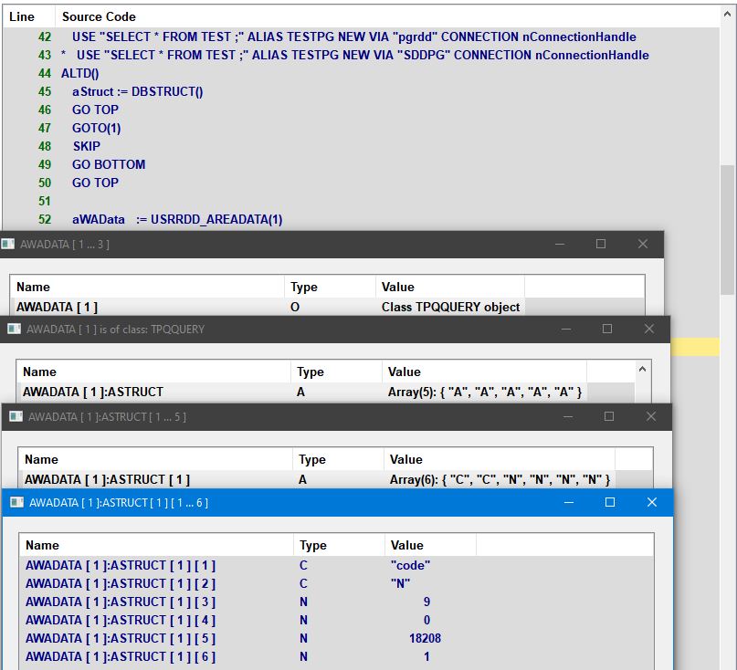

PGRDD.PRG was from harbour v1.x and not include in harbour v3.x any more
as edk found out DbStruct() give Type "U" what Debugger show.
i have check Type and foundout that all is OK ...
   FOR EACH aFieldStruct IN aStruct
       cType := aFieldStruct[ DBS_TYPE ]
       IF VALTYPE( cType ) = "U"
         aField[ UR_FI_TYPE ]  := "C"
         aField[ UR_FI_TYPE ]  := cType
       UR_SUPER_ADDFIELD( nWA, aField )
   /* Call SUPER OPEN to finish allocating work area (f.e.: alias settings) */
   nResult := UR_SUPER_OPEN( nWA, aOpenInfo )
RETURN nResult
as you see i try GO TOP and other "navigation". it does not give Error :D
i don´t understand how USRRDD work but i think we have to go that way to made it easy

have try to "change" Field Type
CASE cType = "C"
   aField[ UR_FI_TYPE ]  := HB_FT_STRING
or
CASE cType = "C"
   aField[ UR_FI_TYPE ]  := ASC("C")-64
both are Number but i get "some" Result
but Type still does not match. :cry:
searching for any other Idea :idea:
