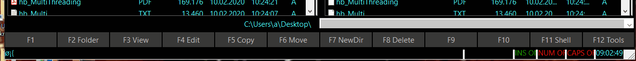

it work that Way with Label as it have BACKCOLOR but using "CREATE EVENT" seem me "limited"
we have
  ON LOSTFOCUS	-> WM_KILLFOCUS
  ON GOTFOCUS 	-> WM_SETFOCUS
but it is not the same like
  WM_MOUSELEAVE
  WM_MOUSEMOVE
  WM_MOUSEHOVER
those Windows Message are not used in h_windows.prg of HMG LIB.
when next Release of HMG include the Event and we must not work with a Workaround.
next Step would be to include WM_MEASUREITEM and WM_DRAWITEM with MEASUREITEM- and DRAWITEM-Structure and a "DrawItem" Codeblock Slot so User can "paint" what he want.
this is a Xbase++ Sample ( have no HMG Sample yet)
p.s. also WS_EX_ACCEPTFILES -> "DropZone" for each Control would be fine so we need no DragAcceptFiles()

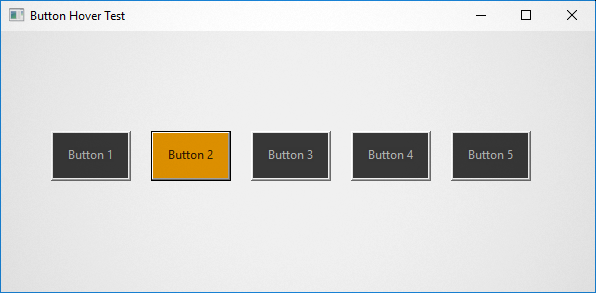

AUGE_OHR wrote: Tue Mar 31, 2020 7:52 am ...
Please be so kind to review the following Minigui sample also:
The source code is attached here (along with the compiled application) :arrow:
HTH 8-)
ButtonHover.zip
(744.68 KiB) Downloaded 203 times
Re: FUNCTION OnMouseHover( hWnd, cFormName )
YES, MiniGUI use much more Events than HMG :!:
ONMOUSEHOVER
ONMOUSELEAVE
i´m still a harbour Newbie and have made my 1st Step with HMG.
now i can "walk" with HMG but to "run" with MiniGUI i still need time. ;)
