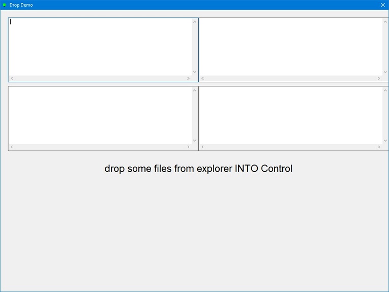

hi
i made a new Sample with 4 Controls. when Drop it will assign it to "that" Control
i have limited it to EDITbox and Textbox, both are Type "EDIT"

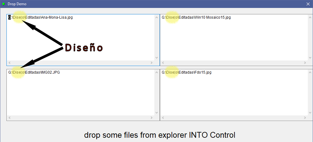

Gracias por tu ejemplo me es muy útil.
Solo que tengo el problema de que los caracteres acentuados no son interpretados en
el EDITBOX como lo muestra ésta imagen de ejemplo.
Sabrás la razón de este detalle ?
Hi jimmy
Thanks for your example it is very useful to me.
Just that I have the problem that accented characters are not interpreted in the EDITBOX as shown in this example image.
Do you know the reason for this detail?

andyglezl wrote: Thu Nov 26, 2020 6:04 am Just that I have the problem that accented characters are not interpreted in the EDITBOX as shown in this example image.
i just can guess : it is ANSI from Explorer

Ok
La solución está aquí... (de edk)
Okay
The solution is here ... (from edk)
https://www.hmgforum.com/viewtopic.php? ... ode#p63652
Para mí, así funciona:
For me, this is how it works:
		CASE nMsg == WM_DROPFILES
			aFiles := DragQueryFileS( nWParam )
			SET( _SET_CODEPAGE, "DEWIN" )
        			SetProperty( "Win1", "EB_DropHere", "Value", aFiles[ 1 ] )
			SET( _SET_CODEPAGE, "UTF8" )
Thanks edk and Jimmy
