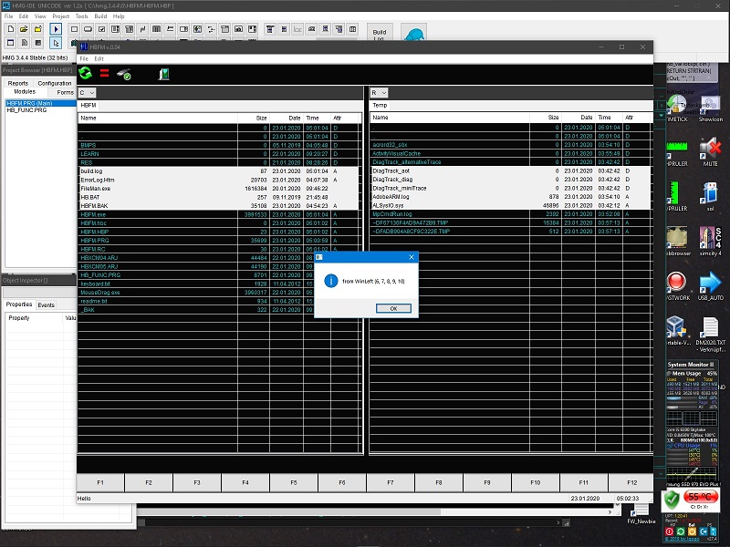

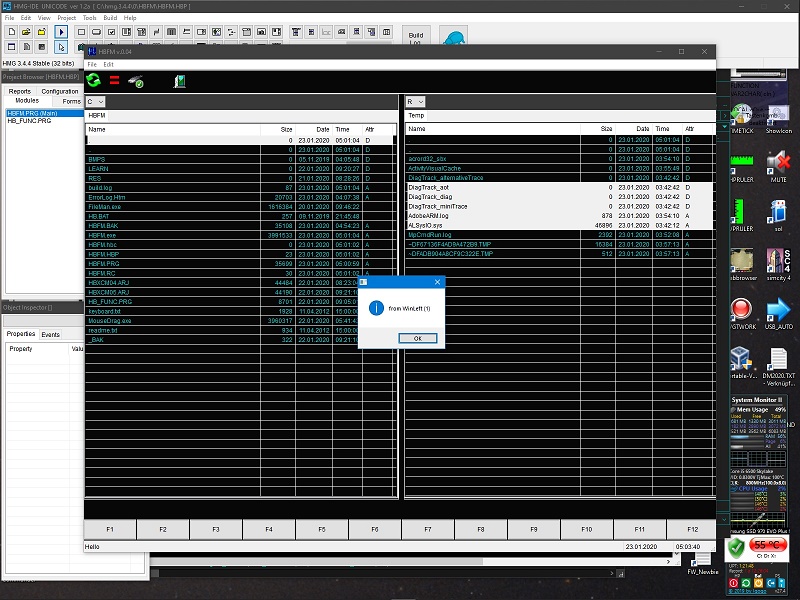

good News : i got ON MOUSEDRAG working :D
bad News ... seems "Codeblock" for Event can only "set" once
  ON MOUSEMOVE DragMoveL() ;
  ON MOUSEDRAG DragHereL(ThisWindow.Name ,WinLeft.Grid_1.Value) ;
  ON MOUSEMOVE DragMoveR() ;
  ON MOUSEDRAG DragHereR(ThisWindow.Name,WinRight.Grid_1.Value) ;
it work fine when DragDrop from left to right
but it fail when DragDrop from right to left ... it say "from left" :(
as you see i try to use it for each WINDOW PANEL
when put it in MAIN ... hm ...

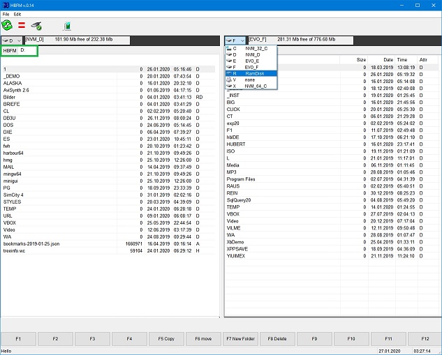

here now Alpha Version 0.010
working :
F5 (DragDrop), F7 and F8
ALT-F1 (left Combobox) ALT-F2 (right Combobox)
Question : how to "use" HMG Combobox with Mouse :idea:
now it only work with ONENTER so have to press ENTER Key ... or react in ONCLOSE
when copy large File you will see Explorer Animation ;)
you can Run "all" like in Explorer as it use same ShellExecute() API
DragDrop will use "COPY". it only work with both GRID.
