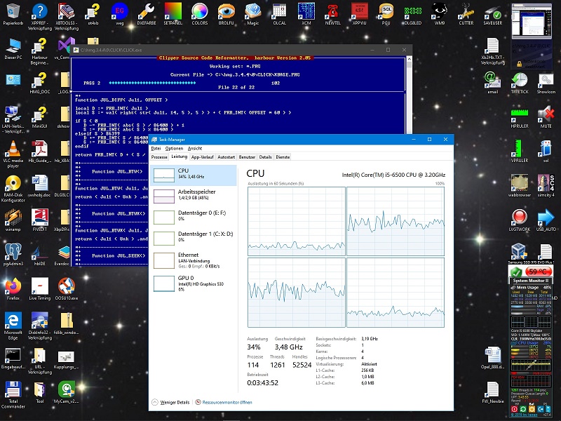

BUT ... it is extreme SLOW even used all 4 Core of my i5 :o

but it is so SLOW so what do i miss :?: it it (default) MT :?:

serge_girard wrote: Sat Dec 07, 2019 2:58 pm Anyway: it works well!
but why is it so SLOW :?:
it is not not only a "bit slower" it is Factor 1000 ... instead of 4 Seconds it need 4000 Seconds.
but it is "only" Cl*pper Code no GUI so i must do something total wrong ... harbour can't be so slow :roll:
please help me to make it faster. which Compiler Option are used for "Cl*pper" :?:
p.s. how to disable MT :?: it seems me that Screen Output is not sync to what he is doing ...
i have use *.HBC with
GUI=NO
MT=NO
and disable
* REQUEST HB_GT_WIN_DEFAULT // Console
it did not show any Windows ... BUT
>>>>>> Click! Run Start: 20191207 22:32:16
>>>>>> Click! Run End: 20191207 22:32:18
NOW it have the Speed using 2 Seconds for same Work :D
so please tell me what is the Difference :?:
why will it be so slow when include
p.s. when not "see" App you can't terminate it and it is still in Taskmanager.
hm ...
i just saw that my Xbase++ Version show "more" than harbour Version
the lower Part is not visible under harbour ... can this made it so slow :?:
