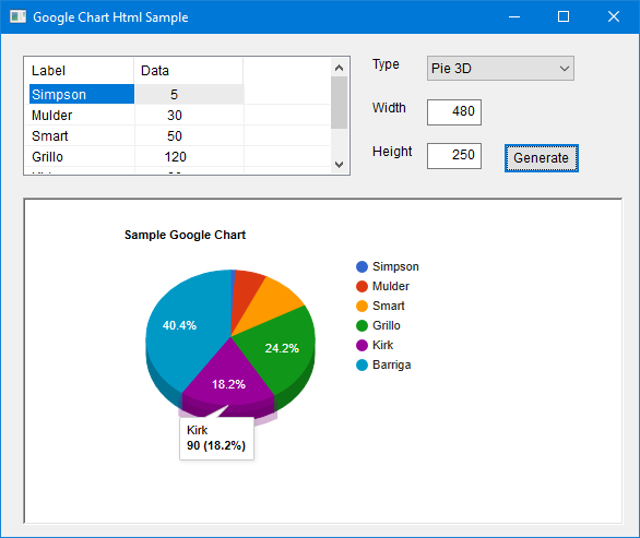

Bez tytułu.png (18.97 KiB) Viewed 8043 times
You can customize the charts by preparing the correct html string. See the Google Chart documentation: https://developers.google.com/chart/int ... uick_start :idea:

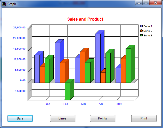

Re: OT: API Google crear gráficas
Posted: Thu Nov 29, 2018 12:25 pm
by bpd2000
Refer samples at:
C:\hmg\SAMPLES\Controls\Graph\GRAPH_03
