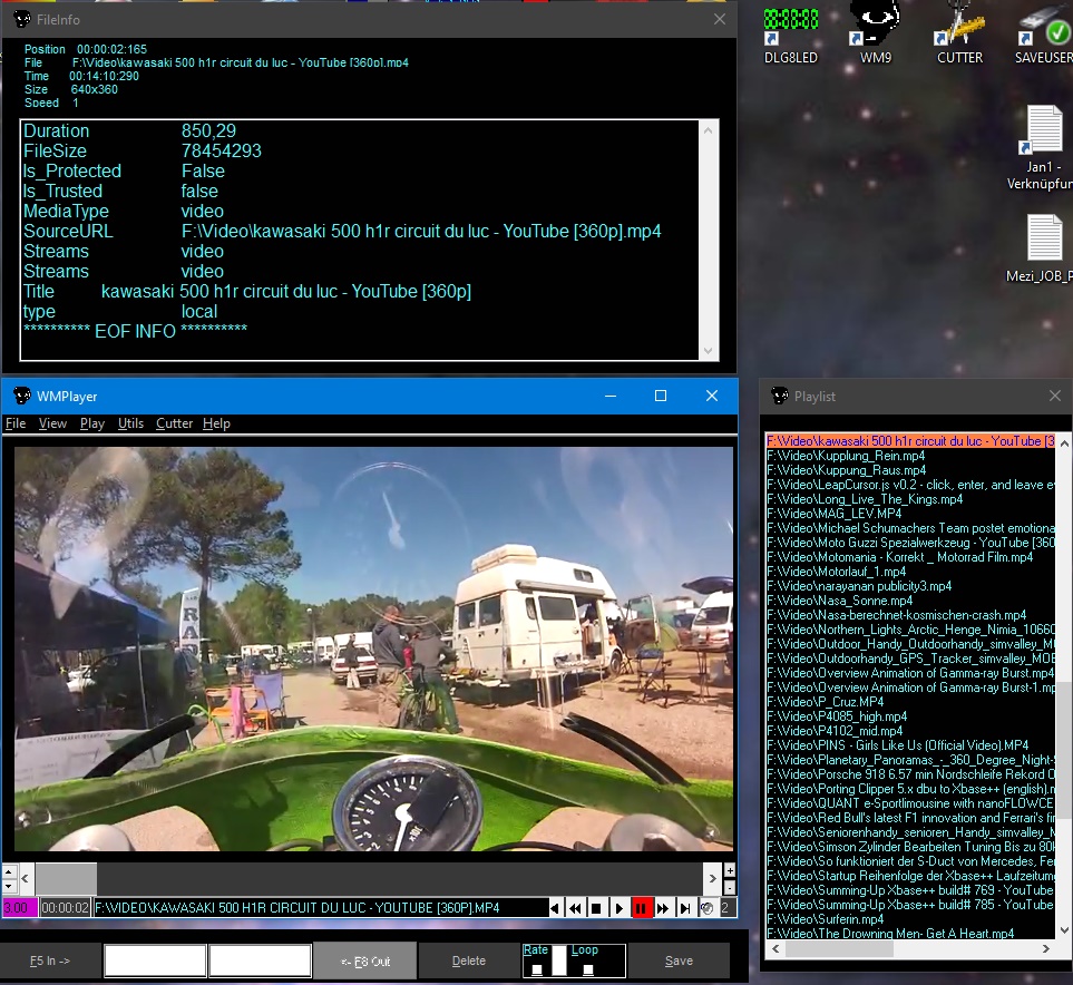

have now try my Xbase++ WMPlayer
C:/hmg.3.4.4/harbour/lib/win/mingw\libhbxbp.a(xbpgra.o):xbpgra.c:(.text+0x20): multiple definition of `HB_FUN_GRASAVESCREEN'
R:/Temp/hbmk_fosqzi.dir/MENUS.o:MENUS.c:(.text+0x1e0): first defined here
ok, i can disable GRASAVESCREEN() in my MENUE.PRG but where ist GRARESTSCREEN :?:
i search in c:\hmg.3.4.4\HARBOUR\lib\win\mingw\libhbxbp.a but not found :o
more missing Function
hbmk2: Error: Referenced, missing, but unknown function(s): ISTHEMEACTIVE(),
THREADINFO(), VAR2CHAR(), DBSCOPE(), ISMETHOD(), XBPEXCEPTION(), BAND(),
UNUSED(), DBPOSITION(), DBGOPOSITION(), FEXISTS(), CREATEDIR(), BOR(),
BIN2VAR(), VAR2BIN(), SETLOCALE(), ISMEMBERVAR(), GRABACKGROUND(),
RANDOMINT(), GRAGRADIENT(), GETAPPLICATION()
so there is a lot work just for my Xbase++ WMPlayer :roll:
