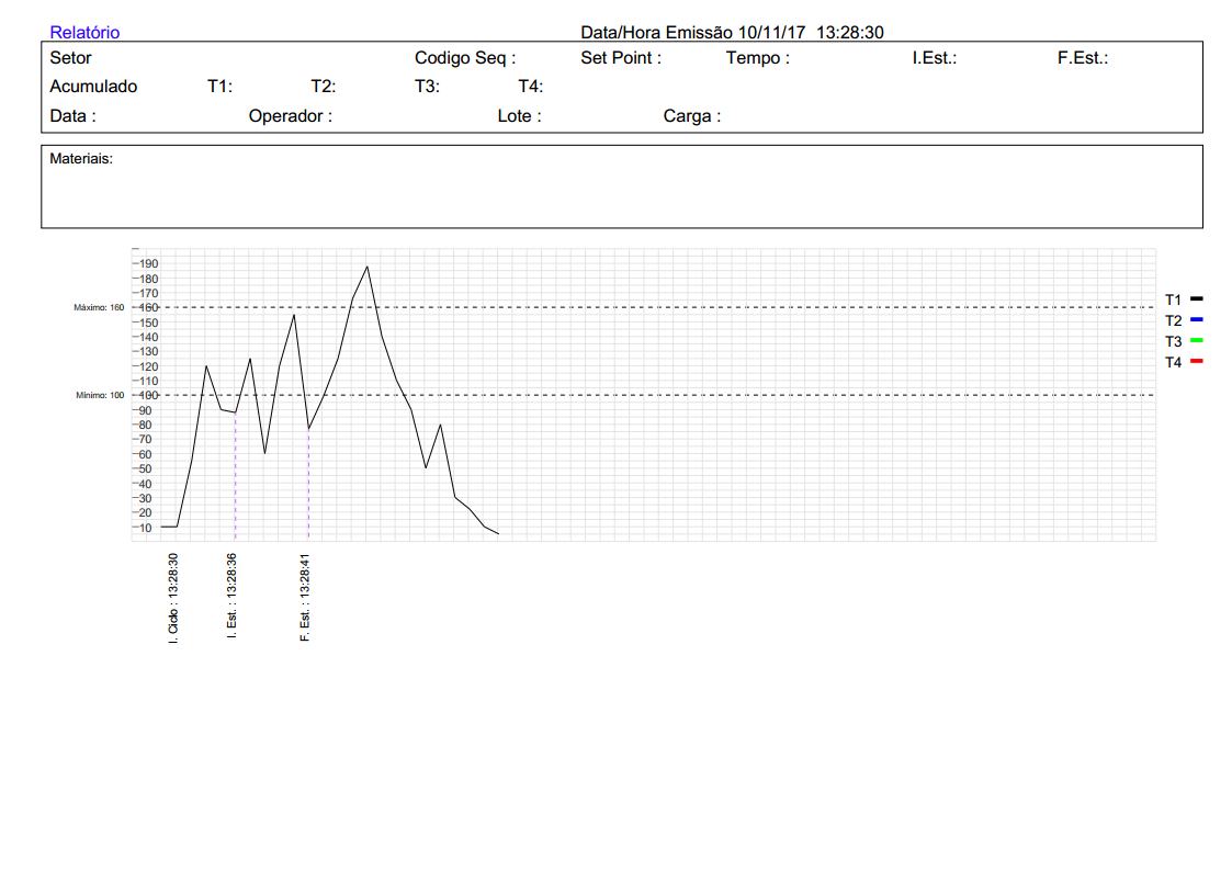

It should be in Ansi.
I think Jair was about the word "Mínimo:" as UTF8 in prg, which show as "MÃ-nimo" in PDF Ansi.
In the example I showed both words.
If you save prg in UTF8, then in PDF you will see MÃ-nimo instead of Mínimo (second word)
Maybe this will be helpful for PDF in UTF8 https://github.com/libharu/libharu/issues/27

edk wrote: Fri Oct 06, 2017 2:21 pm I don't see the problem with accents:
Function Main()
Local i
SELECT HPDFDOC "sample.pdf" ORIENTATION HPDF_ORIENT_LANDSCAPE PAPERSIZE HPDF_PAPER_A4
SET HPDFDOC ENCODING TO "WinAnsiEncoding"
START HPDFDOC
    START HPDFPAGE
     print_grid( 400, 150, 160, 200, 5, 5, 20 , 20 , 10 , 10 )
     HPDF_RotateTextPx( 510, 200, 'MĂ-nimo: 119 -> "Mínimo: "', Nil, 7, 90 , , , , 'T' )  //units: pixels
    END HPDFPAGE
END HPDFDOC
Execute File 'sample.pdf'

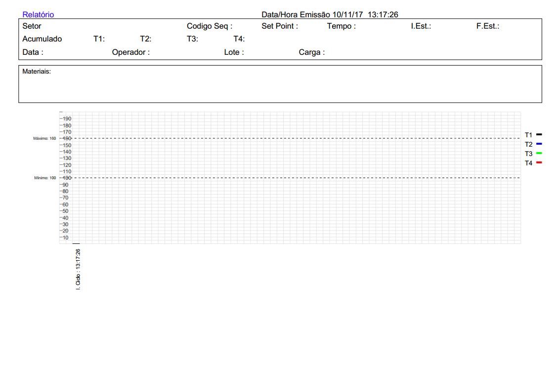

Do you have a .prg file saved in UTF-8? Perhaps this is a problem.
Prg in ANSI works fine: Demo.7z
rotatetext () is okay the problem and in print_grid () follows new code

Hi colleagues:
Edk last code works fine, i've tested.-
Jaipirinho, you must convert prg from UTF8 to ansi, replace ma nimo with Máximo, and save your prg.-
With regards.

Re: pdf grid
Thx Eduardo and Kryzstof ! This works fine.
jairpinho
Posts: 420
Re: pdf grid
Post by jairpinho »
thank you all really my prg file was like utf8 converted to ansi it worked perfectly, it follows the complete design including all the requested topics in a single project, if anyone needs this ready, it was very useful in my project.

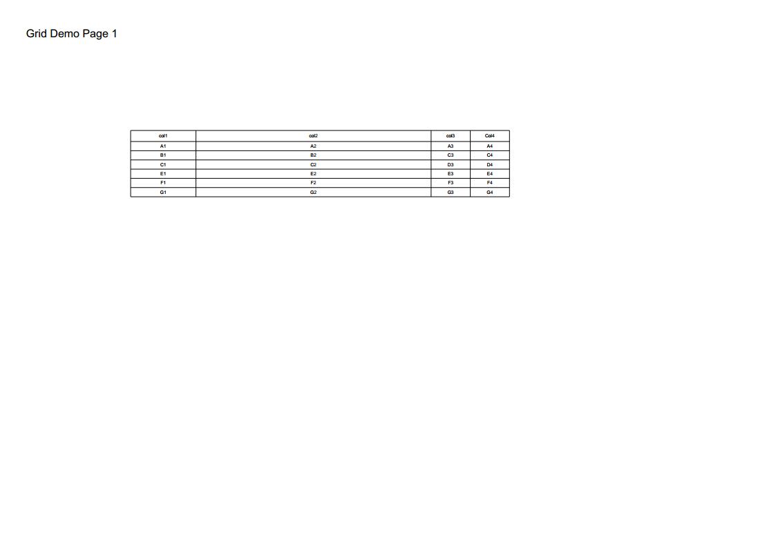

Post by jairpinho »
Hi everyone, I did some tests with grid in pdf where I can customize the herders size of the lines and data in a vector, I am providing the result so that you need
Function teste()
Local i, lSuccess
LOCAL aSize_Col := {25,90,15,15}
LOCAL aSize_Row := {5,10,10,20,20}
Local aDados := {}
	SELECT HPDFDOC "sample.pdf" TO lSuccess ORIENTATION HPDF_ORIENT_LANDSCAPE PAPERSIZE HPDF_PAPER_A4
	START HPDFDOC
    START HPDFPAGE
		//msgdebug(HPDF_Page_GetHeight (_HMG_SYSDATA[ 150 ][ 7 ]))
		 //msgdebug(HPDF_Page_GetWidth (_HMG_SYSDATA[ 150 ][ 7 ]))
 	@10,10 HPDFPRINT "Grid Demo Page 1"
	AADD(aDados , {"A1","A2","A3","A4","A5"})
	AADD(aDados , {"B1","B2","C3","C4","C5"})
	AADD(aDados , {"C1","C2","D3","D4","D5"})
	AADD(aDados , {"E1","E2","E3","E4","E5"})
	AADD(aDados , {"F1","F2","F3","F4","F5"})
	AADD(aDados , {"G1","G2","G3","G4","G5"})
	//MSGDEBUG(LEN(aDados))
	print_grid_A( 50, 50, 10 ,aSize_Col,{"col1","col2","col3","Col4"},aDados)
    END HPDFPAGE
END HPDFDOC
IF lSuccess
Function print_grid_A( nRow_pdf, nCol_pdf, nSize_Row , aSize_Col, aHeaders, aDados )

Re: pdf grid
Es una pregunta ?
Puedes cambiar los siguientes valores para cada columna...
It is a question ?
You can change the following values for each column ...
LOCAL aSize_Row := {5,10,10,20,20} // ************ Where do you use this array?
print_grid_A( 50, 50, 10 , aSize_Col,{"col1","col2","col3","Col4"},aDados)
jairpinho
Posts: 420
Re: pdf grid
Post by jairpinho »
andyglezl wrote: Tue Nov 27, 2018 4:39 am
Es una pregunta ?
It is a question ?
Hello Andrés, yes I had this option I also removed to be equal a window grid with the only option for all lines this vector should be disregarded, the value 10 equals for all lines after the header, the header has a fixed value of 12.
Jair Pinho
