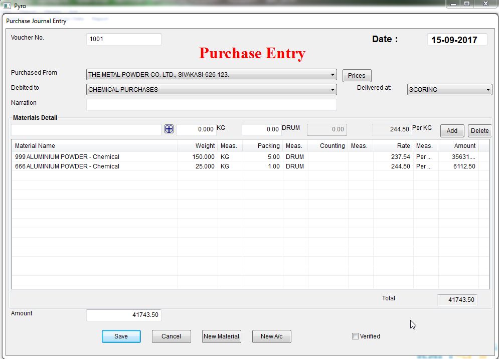

Re: Check for valid
This is what I usually do. When we want a data entry form, I have two buttons viz., 'Save' and 'Cancel'. Standard shortcut keys like Ctrl+S and Escape can also be linked to call these action functions. If an user closes the window without pressing 'Save' that means 'Cancel' or pressing Escape.
Now, whatever be the data required in the form, the user is allowed to enter, navigate through the controls by keyboard or mouse. When he presses the 'Save' button or Ctrl+S, validation of all the controls are checked once and if all of them are 'OK', then the whole data set would be used/saved.
Suppose some fields are interdependent, say only after selecting the item they can enter quantity, there we can use onlostfocus. However, I don't use msginfo() or msgstop(). Instead I would use the status bar or a separate label with red color. This label can be made visible whenever required. By this way the whole focus of the window will not be lost anytime.
This is a typical data entry screen of a live application.

Re: Check for valid
Ya. It is either dd/mm/yyyy or dd-mm-yyyy as you see it. :)
