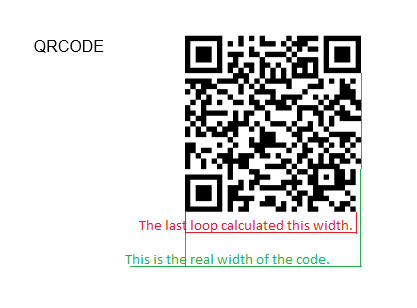

Re: QR Code in HMG
The error is due to an incorrectly calculated QR code width, resulting in an invalid jpg file.

Re: QR Code in HMG
Thx Edk for solve problem with QR
I reported this problem already in 2015:
http://www.hmgforum.com/viewtopic.php?f ... 510#p43023
Now I don't need anymore external QR Code generator in my program.
br Rado
