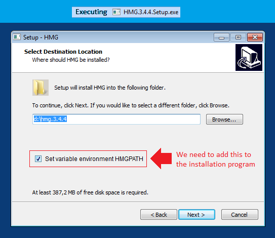

1. When (at what time) should be the HMGPATH-variable created - at installation time of the HMG version or after that?
HMG.?.?.?.Setup.exe could execute the variable creation as soon as the HMG installation is finished. So the installation application will know how to define "where" (in which folder) HMG was installed path.
2. How should that be done - automatically or manual?
I think the user can set this by leaving a checkbox available in case they want to set the HMGPATH variable on your computer.
3. What should the HMGPATH-variable contain at installation time? And after a new HMG-version is released?
HMGPATH should contains the HMG folder (full-path) where was installed without inverse slash bar at end. Example: C:\hmg.3.4.4
And when it is released a new version that this same variable is on put the previous one. The last install always prevailing (unless the HMGPATH checkbox is unchecked).
