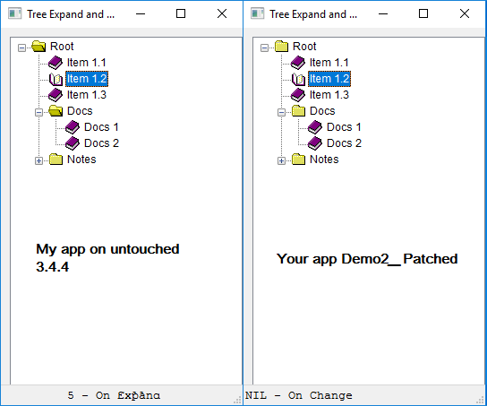

Re: TreeItemValue bug
Thanks Edward for your prompt reponse.
Do you considered right the first value at StatusBar ? I mean the value of TreeItemValue ?
Because I want to have the right value, not the NIL value. This untouched HMG version is with that problem.
And I wish to make a routine based on TreeItemValue.
#1 So, is it a bug ? Can be solved ? The solution presented is not correct ? How it can drive thru the right TreeItemValue ?
More one question: Have you tested by clicking at By untouched HMG version at events doesn't switches images by default. So, we only get change by forcing thru OnExpand/OnCollapse UDF. Right ?
But with wrong value ?
TreeItemValue is not displaying with the "touched" HMG version. That's is the point for I wrote #1 (red color).

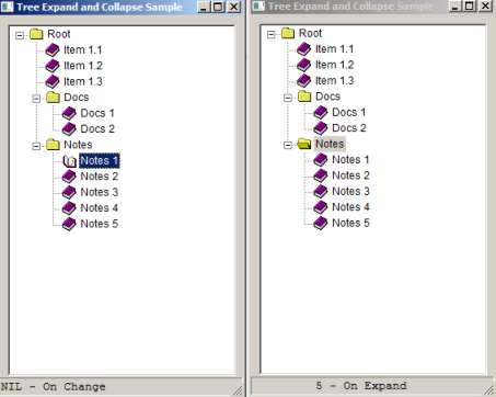

demo2.exe is giving NIL
- serge_girard
- Posts: 3342
- DBs Used: 1 MySQL - MariaDB
2 DBF - Location: Belgium
This is both: 1st demo2.exe
- tree.png (41.98 KiB) Viewed 6746 times
Thank you Serge. So, demo2.exe is untouched HMG version.
Wrong value (NIL) --> wrong result...
First at all, I thank you Edward to keep with me in this discussing. Thank you for your interest and assistance.
Sorry my English is also not so good, but I need to make you understanding me and I will explain again.
"This.TreeItemValue can be used ONLY in events: on expand and on collapse", I do not say the opposite.
The problem as I say: is another one.
So tell me, Am I wrong in this thinking ?
Sorry but I think different and I will tell you why as follows.
Tell me one thing. When you click on to: (Clicking on the rounded red color)
It's part of TREE, right ? (Yes or Not)
When you clicked on "+" or "-" is it at node one or on what else ? In Node one ? (Yes or Not)
So, if all answer are "yes" it's by the same item, then you are quite selecting that or at least making position on the same item, same node, so this node should represents an ID and it should do it with the right ID. Not with NIL ID value.
I am pretty sure what the user expect to be instead that.
And more...
Try to imagining another needing. As you said with two different images based only, it's so easy.
But when you have different images for different NODES ? You will need a right ID.
When we have a ImageList you certainly will need the right value, current value even by click on "+" of TREE.
What in short I mean is: expand/collapse should not change the focus but also can not change its position to NIL.
NIL is not numeric, we can not find the current clicked item... not with NIL.
NIL it is wrong.
You do not need make focus with expand/collapse events but you are clicking on that... and that needs to be identificable.
Remarks:
I also agree with that but the event results are not correct, at least not for TreeItemValue.
You are absolutly right but not for the same reason that you "need" (*1) to force TreeItemValue to NIL.Because these events do not change the focus to the node, expanded/collapsed node is NOT selected, they can not be read by the this.value property.
That's means that only for TREE is different ? Come on... (*2) Are you sure to be needed like this ?
By the untouched HMG version yes. But I do not agree with that.In other words, the node / item image is changed only when it is focused (selected)
Yes, this I understood and then proceed in accordingly when is one type of node. But then you can not proceed rightly when the TreeItemValue is NIL.We can "deceive" the tree control by changing the unselect node image to the same as the select node image, at the time of the expand event.
And more...
NIL it is wrong.
Remarks:
- (*1) When I said you "need" I mean with untouched HMG version. Wrong TreeItemValue value from HMG even at TREE for expand/collapse.
- (*2) Come on... it's an expression like as. "I can not believe in that".

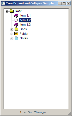

Edward, probably with your technical experience you could make it work this:
I wish to keep different nodes images by changing when be expanded/collapsed.
Do you think is it possible with current HMG ?

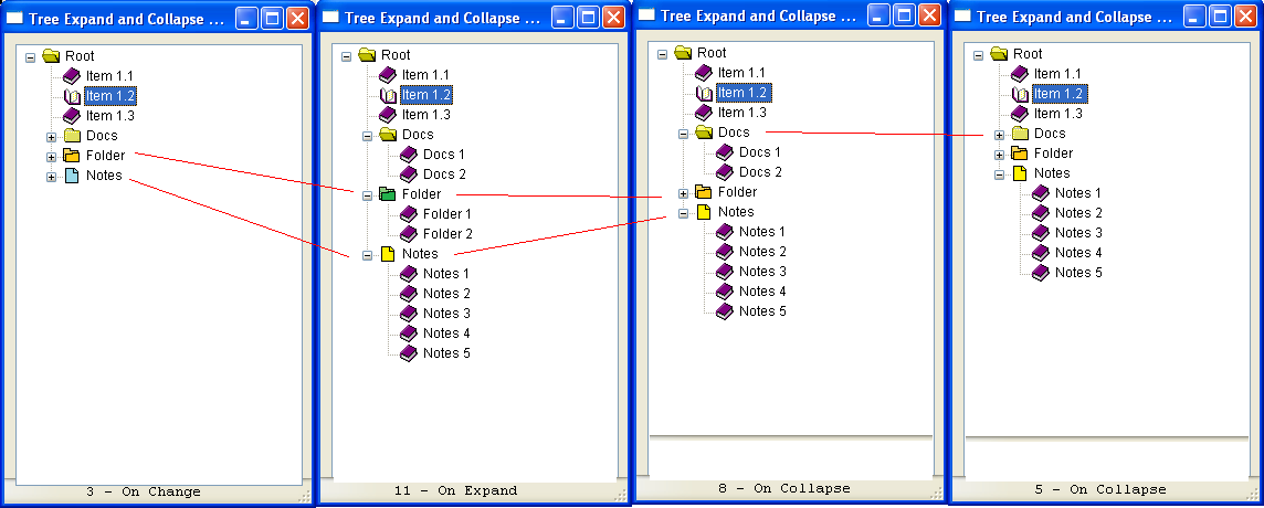

Pablo.Pablo César wrote: ↑Fri Apr 28, 2017 5:56 pm Edward, probably with your technical experience you could make it work this:
Did you mean such a tree action?

Let me disagree with you.Pablo César wrote: ↑Fri Apr 28, 2017 5:14 pm It's part of TREE, right ? (Yes or Not)
Point me to where is the definition of tree object (+) / (-)? This is not a Node. Nodes are: 'Root', 'Docs', 'Folder', 'Notes'
(+) / (-) these are elements that have no definition, and as such values in Tree. So they are not part of a tree - in the sense that Expanded / Collapsed does not affect tree values.
They only serve to change the presentation of tree elements. And therefore they are handled separately from the rest of the tree.
