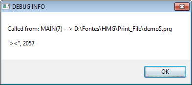

Ops... this could it be an error of identification language. Please would you be so kind to run this attached app:
Demo5.rar
App to identify your current language
(1.25 MiB) Downloaded 528 times
And post the screen captured to see it, please.

1. I must first apologize for point no 4. It was my mistake, there was a space in file name and that' s why I was getting file not found error. It is resolved now.
2. I get following on running demo5
Msg on running demo5.exe
PrintFile Msg.png (7.07 KiB) Viewed 10410 times
Thanks
PrintFile for text files
Thank you Rajeev for your return.
About your test at #4, there is no problem.
I appreciate your interest and persistence.
Thanks to this I understand that we can not always automate the language issue.
It may be best left to the discretion of the user and not be automated.
I also found the bug in the lack of language identification, which I will implement but as I said, I will first leave it to the user's selection.
The client is always the boss, is not doesn't it ?
Then I will have to write the .INI language file and make another option so user can modify the selection.
Thanks again, without your feedback, the application and function languages would be incomplete.
I will make new release.
