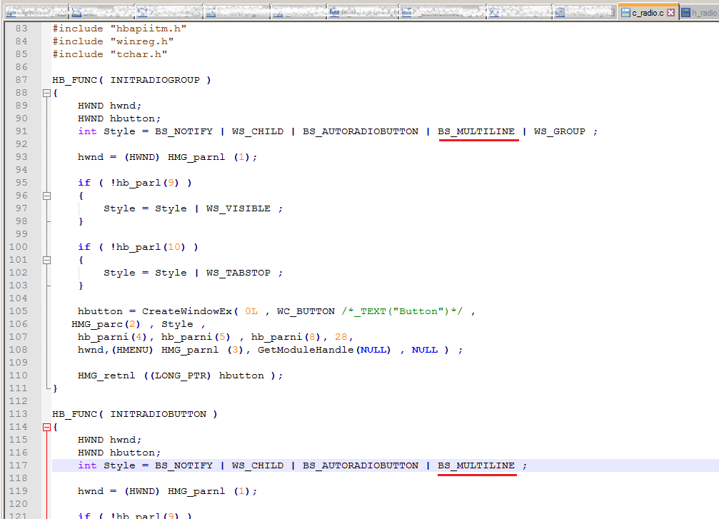

Sorry, Krzysztof. Nothing missing is the same code I have, but... now I remembered that I had left more this BS_MULTILINE style in the functions: INITRADIOGROUP, INITRADIOBUTTON and SETRADIOSTYLE of the HMG source code. It had done in test character and ended up staying.
But now even removing and in trying to set style with BS_MULTILINE does not work the same way as when the RadioGroup is started. :|
I have no idea how to solve it. All tests I just done, doesn't work as being native of HMG function with plus this BS_MULTILINE.

RadioGroup can be MULTILINE
Another strange thing is the SETRADIOSTYLE C function that is never been used in HMG...

  3. Ya que el comportamiento es estraño al intentar colocar BS_MULTILINE (no obedece como deberia o al menos no sé si estoy haciendo algo mal) al estilo del RadioGroup.
    Por lo tanto sugiero incluir más un estilo (BS_MULTILINE) fijo en las funcion en C del RadioGroup, puede ser ?
