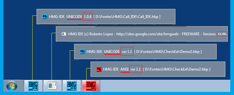

At this Call_IDE pack is also working with another project HMG_Version\InstalledAt and I have fixed many things between them at the same time or alternately at least.
Remember that properly configured Call_IDE can open in your choice any of the IDE now installed on your HD. Be it UNICODE or ANSI according to the option of each version chosen.
As you can see in the figure above, four projects were opened in different versions (different IDE as well). This differentiation of having an extra shortcut side by side and not over by over is from the operating system itself because it interprets that they are different programs.

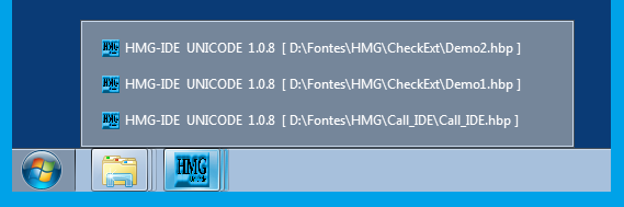

But if the same version of IDE is called with multiple projects these will be overriding the same shortcut in the TaskBar. This is typical of the operating system.
Three project open, three instances, same program (IDE.exe same version) all it's superimposed.
