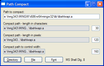

Done. Two versions: one in C, second in HMG.
Please compare them.

Perfect !!
Quite same speed (little time difference) when executing both.
PathCompact_C seems faster, but for really.

I is really good.
I will not need to make automatic lenght. Because the example item "Compact path to control width" serves the same purpose.
Thank you very much Krzysztof. You're so kind and also competent.
