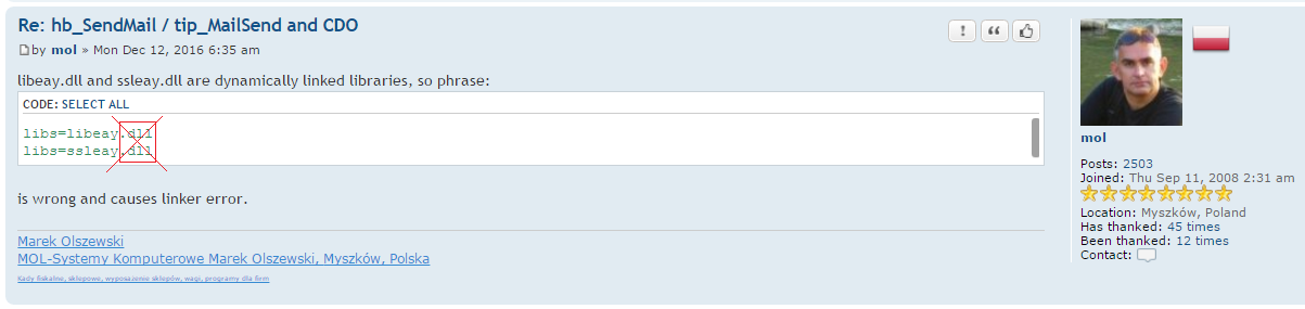

libeay.dll and ssleay.dll are dynamically linked libraries, so phrase:
libs=libeay.dll
libs=ssleay.dll
is wrong and causes linker error.
hb_SendMail / tip_MailSend and CDO
Marek, please remove .dll at your .hbc file.
Let it like I have indicated:
