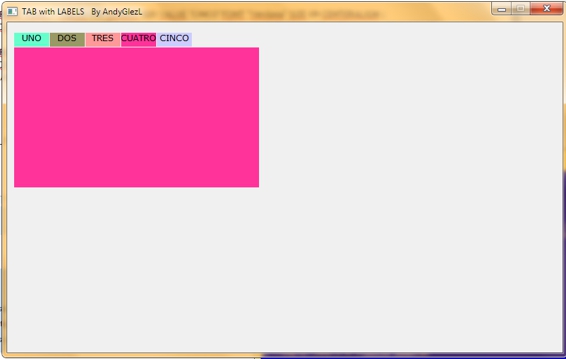

Re: Colorear las PAGE
Hola AidTIC
Quizá te pueda servir este demo que simula un TAB con colores...
Hello AidTIC
Maybe you can use this demo that simulates a TAB with colors ...
FUNCTION Main()
   DEFINE WINDOW Form_1 AT 50,50 WIDTH 800 HEIGHT 500 NOMAXIMIZE NOSIZE TITLE "TAB with LABELS   By AndyGlezL" MAIN
	ON KEY ESCAPE OF FORM_1 ACTION Form_1.Release
	// ********   TAB SIMULADO
       @ 15,010 LABEL L0  PARENT Form_1 WIDTH 050 HEIGHT 020 VALUE "UNO"	FONT "Verdana" SIZE 09 CENTERALIGN ;
				FONTCOLOR BLACK  BACKCOLOR { 102 , 255 , 204 } ACTION Form_1.L5.BACKCOLOR := Form_1.L0.BACKCOLOR
       @ 15,061 LABEL L1  PARENT Form_1 WIDTH 050 HEIGHT 020 VALUE "DOS"	FONT "Verdana" SIZE 09 CENTERALIGN ;
				FONTCOLOR BLACK  BACKCOLOR { 153 , 153 , 102 } ACTION Form_1.L5.BACKCOLOR := Form_1.L1.BACKCOLOR
       @ 15,112 LABEL L2  PARENT Form_1 WIDTH 050 HEIGHT 020 VALUE "TRES"	FONT "Verdana" SIZE 09 CENTERALIGN ;
				FONTCOLOR BLACK  BACKCOLOR { 255 , 153 , 153 } ACTION Form_1.L5.BACKCOLOR := Form_1.L2.BACKCOLOR
       @ 15,163 LABEL L3  PARENT Form_1 WIDTH 050 HEIGHT 020 VALUE "CUATRO"	FONT "Verdana" SIZE 09 CENTERALIGN ;
				FONTCOLOR BLACK  BACKCOLOR { 255 , 51  , 153 } ACTION Form_1.L5.BACKCOLOR := Form_1.L3.BACKCOLOR
       @ 15,214 LABEL L4  PARENT Form_1 WIDTH 050 HEIGHT 020 VALUE "CINCO"	FONT "Verdana" SIZE 09 CENTERALIGN ;
				FONTCOLOR BLACK  BACKCOLOR { 204 , 204 , 255 } ACTION Form_1.L5.BACKCOLOR := Form_1.L4.BACKCOLOR
       @ 36,010 LABEL L5  PARENT Form_1 WIDTH 350 HEIGHT 200 VALUE ""		FONT "Verdana" SIZE 09 ;
   CENTER WINDOW Form_1
   ACTIVATE WINDOW Form_1
Bien pensado Andrés. En forma de label es más liviano. Aunque se hiciera con imagenes, iria tener un efecto mejor.

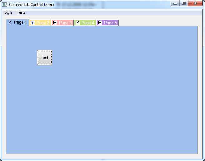

serge_girard wrote:Hello Grigory,
On my W7 all is yellow?
Hello Serge,
Thanks for your interest!
I've attached a new version of the colored Tab control for a next MiniguiEx build.
Hope that useful :arrow:
COLORED_TAB.ZIP
(627.84 KiB) Downloaded 357 times

gfilatov wrote:I've attached a new version of the colored Tab control for a next MiniguiEx build.
WOW Grigory !
You are a genious !
I had thought that it would never be possible.
Congratulations !

Hi Grigory:
Excellent job.-
Both news you introduce are really usefull: Color Tabs, and locate tabs on bottom of tab control.-
Thanks for share.-
With regards.
Eduardo
