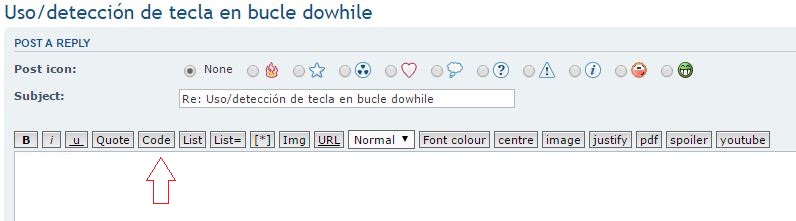

  • - Put your code in "code" section:
    This will protect format (indentation etc) of your code and keep shorter its view.
    - Send your long text (including prg code) as attachment, this too will keep your post shorter.

Bienvenido Oscar al foro de HMG.
intenta usar "Full Editor /Preview" dentro del editor usar todas las herramientas que creas necesaria para darle forma al texto.
