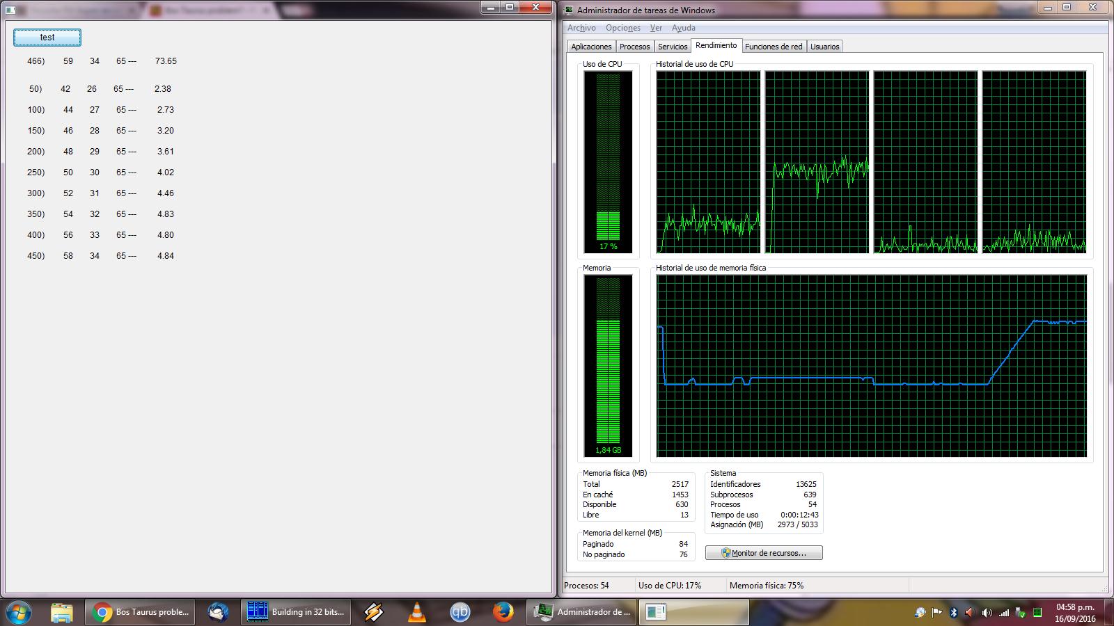

Sadly, the problem remains here (Windows 7 Pro 32 bits).
The program generates 467 images, being the last a black one.
I'm attaching the first image and the 466th.
I've changed the main window in the demo to topmost and shred the desktop between it and the task manager showing system memory usage.
Capture #1:
Capture #466:

I've modified the test program to capture the desktop and then release the bitmap WITHOUT saving (not calling BT_BitmapSaveFile) and the memory consumption remained steady across 1000 iterations, so the problem is at saving (BT_BitmapSaveFile).
Re: Bos Taurus problem?
Another clue:
If in the original (unmodified) example, you change the file extension to '.bmp' all works fine.
So, the problem should be in bt_SaveGDIPlusPicture() used when type is not bmp.
Maybe, there is some memory used and not released there...
