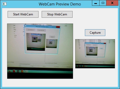

brain wrote: Kindly send the necessary library for this function. tnx and more power.
You can not to compile the above code in HMG because it is for a fork MiniGUI Ex at http://hmgextended.com.
Please be so kind to try the code which was kindly uploaded by Mustafa.

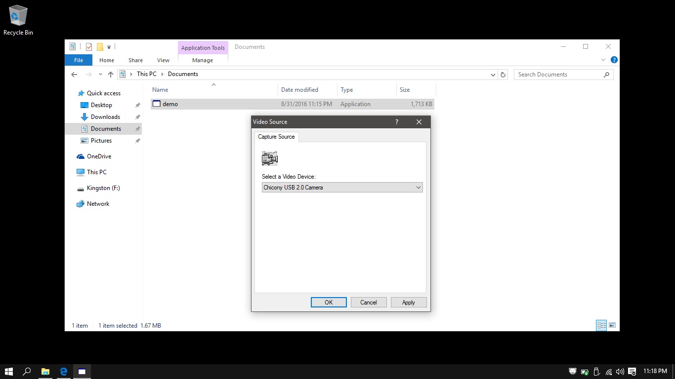

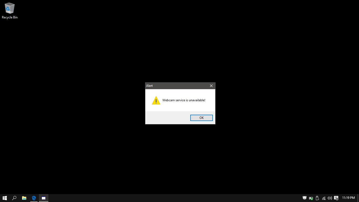

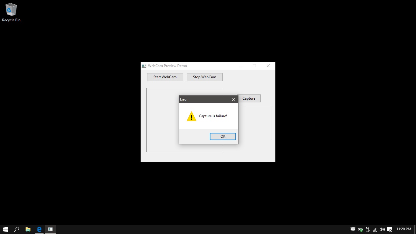

good day mr gfilatov run ur demo.exe and this is what happened

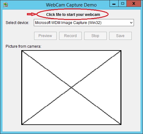

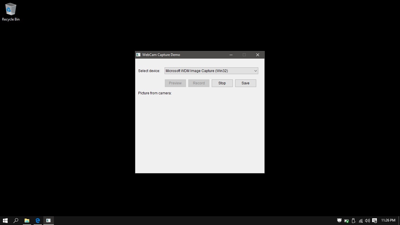

and for mr Mustafa good day too. I ran your program too and nothing happened too. tnx for sharing.

I found no problems with both programs.
Have you press the button top of the screen ?

hi quartz good day. try run the program on a 64bit OS like what I am using windows 10. tnx and more power HMG.
