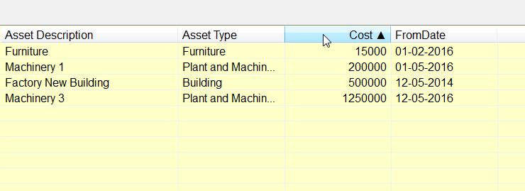

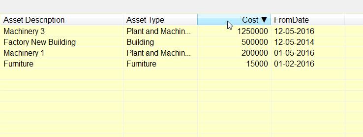

A slight improvement to the procedure:
Now any grid column header can be clicked in ascending order. Immediately if you click again on the same column header it will be arranged in descending order.
Unicode arrow characters are suitably added to the column headers.
Claudio: Can we have a property to find out ColumnHeadClicked just like CellColClicked?

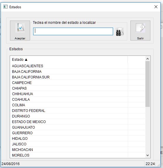

Utilice tu funcion de SORTGRID, y ya me pone la flecha y me ordena el grid, pero si doy clic en la flecha no hace nada, yo implemente asi en mi codigo
SortGrid("Frm_ShowStates" ,"Grd_States" , 1, "C", .T. ) pero no funciona.
Use your SORTGRID function, and it makes me arrow and ordered me the grid, but if I click the arrow does nothing, so I implement in my code
SortGrid ("Frm_ShowStates", "Grd_States", 1, "C", .T.) Does not work.
As you can see in the code, the fifth parameter is not used inside the function. Have you clicked repeatedly the same column and the ascending and descending order are working alternatively. Right?

I try differents test:
SortGrid("Frm_ShowStates" ,"Grd_States" , 1, "C",.F. )
SortGrid("Frm_ShowStates" ,"Grd_States" , 1, "C",.T. )
SortGrid("Frm_ShowStates" ,"Grd_States" , 1, "C")
I try diferents way
and any case dos no work. I'm using SQLITE

Please try to use the following procedure. This will take care if the 5th parameter is present.

Re: Grid Sort (Function / Method)
KDJ wrote: Wed Jan 11, 2017 8:03 pm Below I present a different solution (set HDF_SORTUP/HDF_SORTDOWN format in listview header).
#include 'hmg.ch'
FUNCTION Main()
  SET FONT TO 'MS Shell Dlg', 8
  OpenDB()
  DEFINE WINDOW MainWA;
    MAIN;
    WIDTH  380;
    HEIGHT 290;
    TITLE  'Grid - Sort Header';
    NOMAXIMIZE;
    NOSIZE
    DEFINE GRID CompGR
      ROW             10
      COL             10
      WIDTH          350
      HEIGHT         180
      HEADERS        {'RecNo', 'Name', 'Code', 'Price'}
      WIDTHS         {75, 110, 70, 70}
      CELLNAVIGATION .T.
      ROWSOURCE      'Comp'
      COLUMNFIELDS   {'RecNo()', 'Name', 'Code', 'Price'}
      JUSTIFY        {GRID_JTFY_RIGHT, GRID_JTFY_LEFT, GRID_JTFY_CENTER, GRID_JTFY_RIGHT}
    END GRID
    DEFINE BUTTON ExitBU
      ROW     200
      COL     140
      WIDTH    80
      HEIGHT   25
      CAPTION 'E&xit'
      ACTION  MainWA.RELEASE
    END BUTTON
    DEFINE MAINMENU
      DEFINE POPUP 'Set order'
        MENUITEM 'RecNo' ACTION SetOrder(1, .F.)
        SEPARATOR
        MENUITEM 'Name - ascending'  ACTION SetOrder(2, .F.)
        MENUITEM 'Name - descending' ACTION SetOrder(2, .T.)
        SEPARATOR
        MENUITEM 'Code - ascending'  ACTION SetOrder(3, .F.)
        MENUITEM 'Code - descending' ACTION SetOrder(3, .T.)
        SEPARATOR
        MENUITEM 'Price - ascending'  ACTION SetOrder(4, .F.)
        MENUITEM 'Price - descending' ACTION SetOrder(4, .T.)
      END POPUP
    END MENU
  MainWA.CompGR.RECNO := RecNo()
  MainWA.CompGR.ColumnONHEADCLICK(1) := { || SetOrder(1) }
  MainWA.CompGR.ColumnONHEADCLICK(2) := { || SetOrder(2) }
  MainWA.CompGR.ColumnONHEADCLICK(3) := { || SetOrder(3) }
  MainWA.CompGR.ColumnONHEADCLICK(4) := { || SetOrder(4) }
  SetOrder(2, .F.)
  MainWA.CENTER
  MainWA.ACTIVATE
FUNCTION SetOrder(nColumn, lDescend)
  LOCAL nOrder  := ordNumber(ordSetFocus())
  LOCAL nRecord := MainWA.CompGR.RECNO
  GridHeader_SetSort(MainWA.CompGR.HANDLE, nOrder + 1, 0)
  IF ValType(lDescend) != 'L'
    IF nColumn == 1
      lDescend := .F.
      lDescend := If(nOrder == nColumn - 1, ! ordDescend(nOrder), .F.)
  nOrder := nColumn - 1
  GridHeader_SetSort(MainWA.CompGR.HANDLE, nColumn, If(lDescend, -1, 1))
  ordSetFocus(nOrder)
  ordDescend(nOrder, NIL, lDescend)
  MainWA.CompGR.RECNO := nRecord
  MainWA.CompGR.REFRESH
FUNCTION OpenDB()
