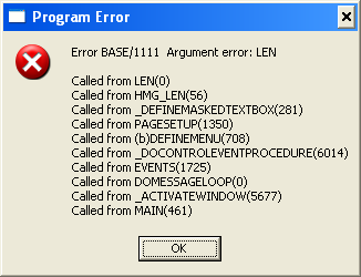

Page setup some error:
- err.PNG (10.59 KiB) Viewed 7033 times
Re: Another enhancement to HFCL WordScribe and WordWriter
Thanks for reporting! This is now fixed. (It was in WordScribe.)bpd2000 wrote:Page setup some error:
