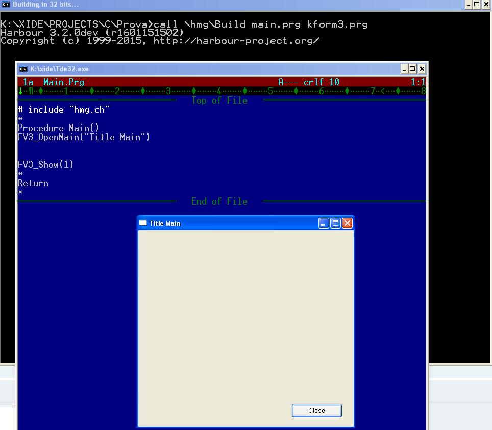

No Ide
Build.Bat in HMG foder
- Immagine.JPG (71.53 KiB) Viewed 6815 times
Re: Dynamic Controls - a good idea
Thanks, this works:
#include "KForm3.prg"
procedure main()
FV3_OpenMain('Empty Window')
FV3_Show(1)
FV3_Result()
return
