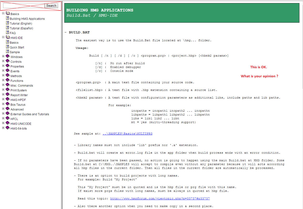

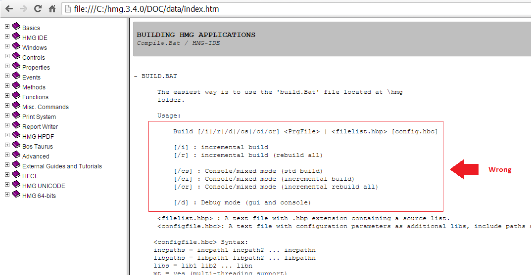

Since a long time, also my blame, there is a wrong syntax at Building app, as showing this:
This is not used anymore at long time ago...
This page I've already fixed but it's with some different colours... (see below):
As you can see I have tried to implement a search mechanism for strings locating. But making in simple html is very hard to do it and it's turned defficiently.
If this is approved, I prepare separe page and Rathinagiri can replace it for a old one. ;)
IMHO, we have to facilitate to anyone whos want to re-edit this hmgdoc. Probably posting in a topic to be updated by Mr. Rathinagiri for next releases or having access in specific area of the forum for uploading files ready for updates.
B.Rgds

Pablo César wrote:In hope of some day any good soul can be fix and improve our hmgdoc. I will post here the errors at our documentation.
B.Rgds
I like !!!

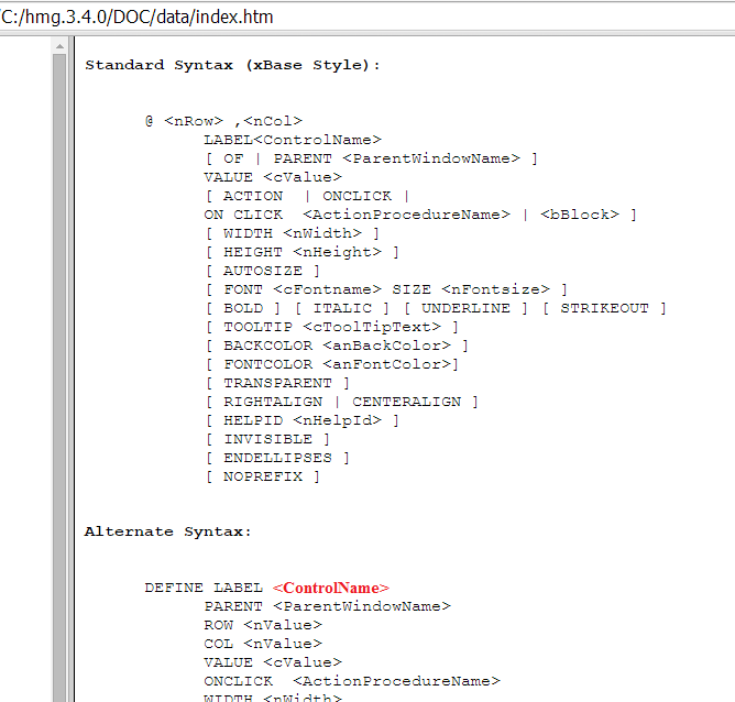

Small missing at DEFINE LABEL
( SOLVED )
Pablo César wrote:Small missing at DEFINE LABEL
Done.
Done.
Muchas gracias Claudio ! :D

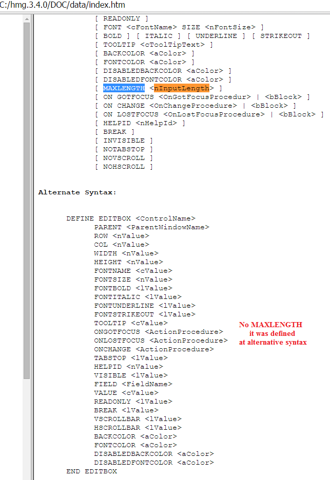

I found another small missing at DEFINE EDITBOX
( SOLVED )
