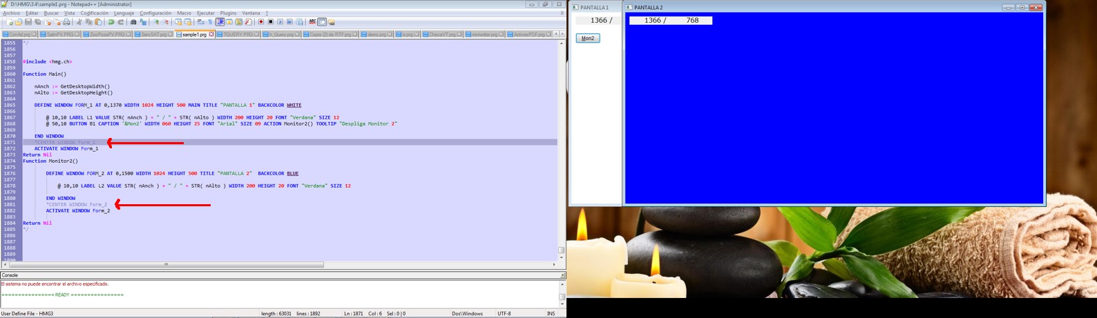

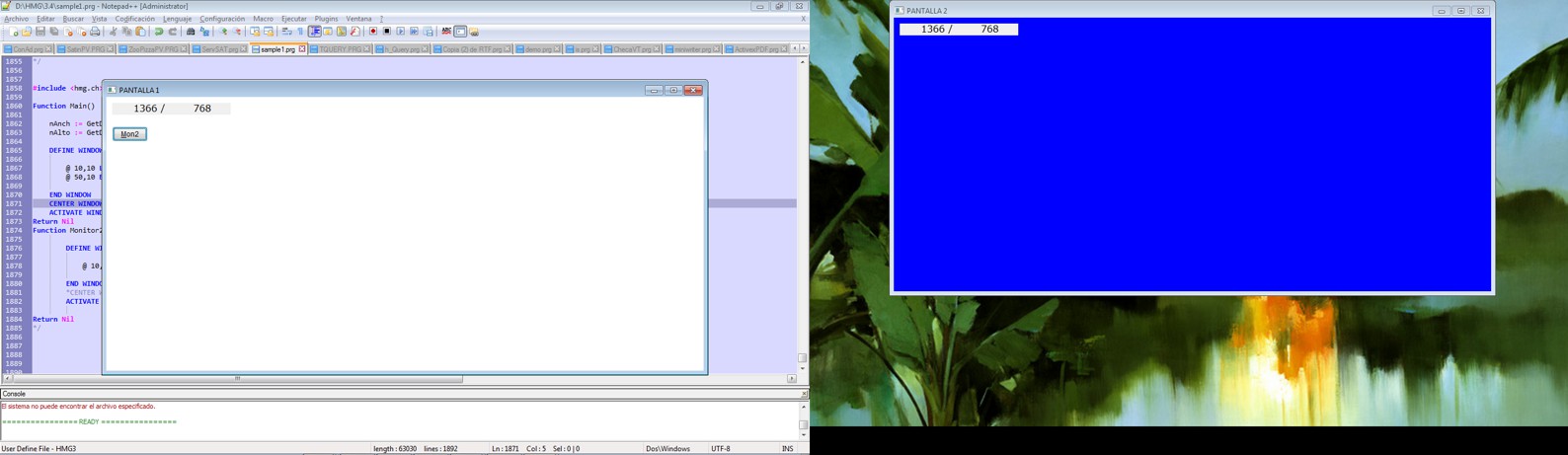

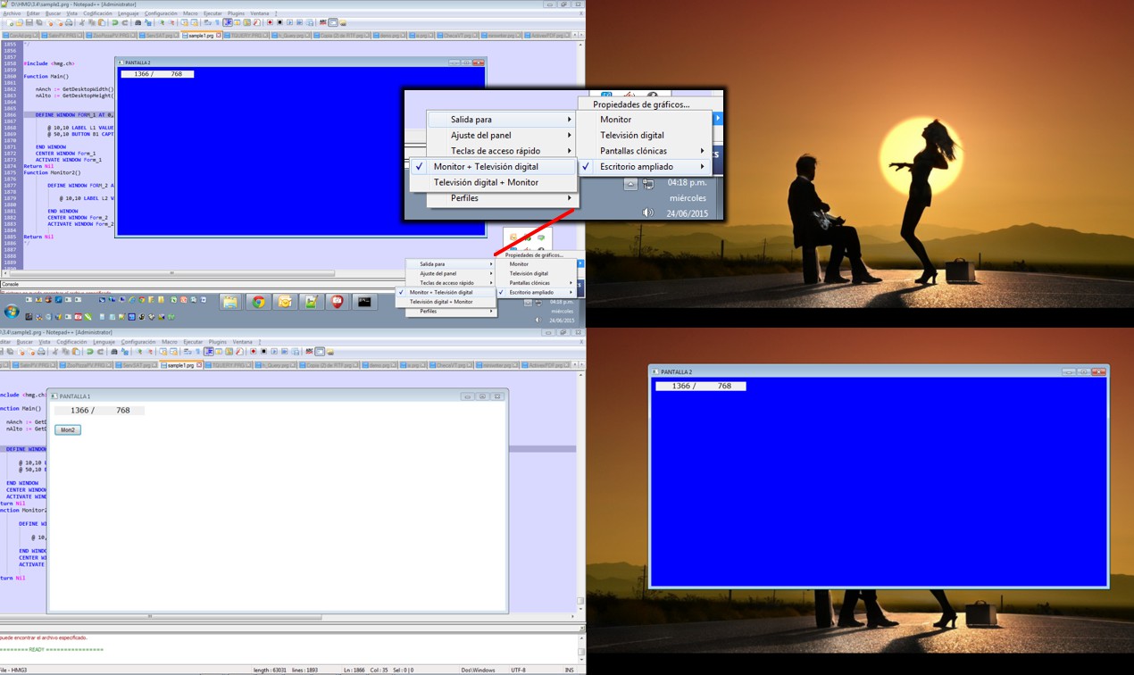

Hola Mol
Como es tu configuracion para la salida de los monitores ?, porque siempre me lo despliega en el primero.
Solo aparece si yo lo muevo manualmente.
Hello Mol
As your output settings for the monitors?, Because I always displays it in the first.
Displayed only when I move it manually.
Function Main()
	nAnch := GetDesktopWidth()
	nAlto := GetDesktopHeight()
	DEFINE WINDOW FORM_1 AT 0,1370 WIDTH 1024 HEIGHT 500 MAIN TITLE "PANTALLA 1" BACKCOLOR WHITE
		@ 10,10 LABEL L1 VALUE STR( nAnch ) + " / " + STR( nAlto ) WIDTH 200 HEIGHT 20 FONT "Verdana" SIZE 12
		@ 50,10 BUTTON B1 CAPTION '&Mon2' WIDTH 060 HEIGHT 25 FONT "Arial" SIZE 09 ACTION Monitor2() TOOLTIP "Despliga Monitor 2"
	CENTER WINDOW Form_1
	ACTIVATE WINDOW Form_1
Function Monitor2()
		DEFINE WINDOW FORM_2 AT 0,1500 WIDTH 1024 HEIGHT 500 TITLE "PANTALLA 2"  BACKCOLOR BLUE
			@ 10,10 LABEL L2 VALUE STR( nAnch ) + " / " + STR( nAlto ) WIDTH 200 HEIGHT 20 FONT "Verdana" SIZE 12
		CENTER WINDOW Form_2
		ACTIVATE WINDOW Form_2

Quitando la siguiente linea, lo despliega en el segundo monitor...
By removing the following line is displayed on the second monitor ...
YES !
