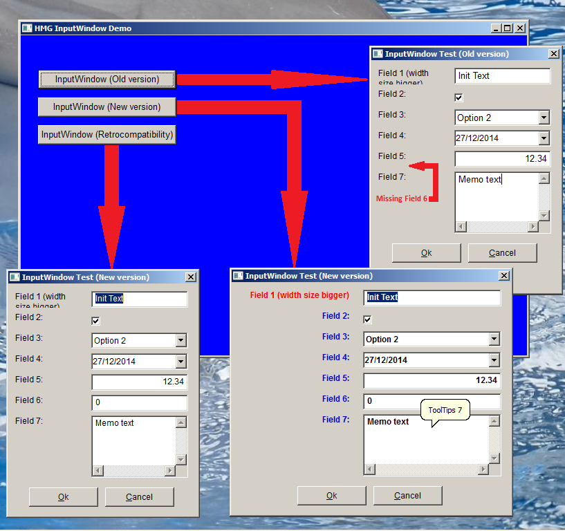

* Two bugs was fixed:
  1. When at _DefineMaskedTextbox (wrong array address.).
  2. Corrected to MASKEDTEXT at SetMethodCode.
* Enhanced:
  1. Added new behaviour when is focused changes font color.
  2. New Demo is attched file, just to prove full retrocompatibility of the updated InputWindow2 to the old InputWindow:
    Please note Field 6 is ausent in the old InputWindow, due is lack of numeric textbox for integers.
    See at field 1, labels in old InputWindow version is cutting (no way to fix width size).
Probably I will find a way to include Grid at next releases.

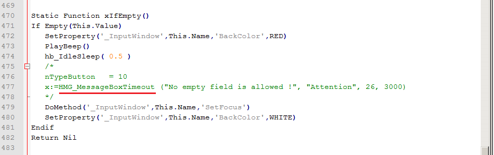

Dear Claudio,
I wish to use HMG_MessageBoxTimeout at xIfEmpty(), instead of: hb_IdleSleep( 0.5 )
But the implementation of HMG_MessageBoxTimeout is interfering with the event. How could I use it properly ?

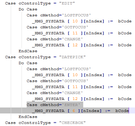

apais wrote:Sería posible de que los campos 2 ( checkbox) y 4 (date field ) se pudiera salir con ENTER y no solamente con TAB ?
Hola Angel,
Para que el evento ENTER ocurra de una forma convencional como con TextBox, ComboBox, etc.,
1. En el caso del CheckBox, creo que deberia hacerse cambios en el source. Porque se ve que el código posue:
  • _HMG_SYSDATA [ 16 ] [k] := _HMG_SYSDATA [ 266 ] (La descricion es:_HMG_ActiveTabButtons)
    No sé si es posible adicionar este nuevo evento (ENTER) internamente al CheckBox. Talvez Claudio pueda respondernos.
    Otra salida, seria crea un evento para este control, lo que dejaria de ser una rutina genérica y pasaria ser exclusiva.
2. Ahora en el DatePicker, verifiqué que podria utilizarse sin problemas y está corregido. Gracias por avisar.
  • Para resolverlo ahora, en la funcion SetMethodCode en el Case cControlType = "DATEPICK" agregale:

apais wrote:It would be possible that the 2 fields (checkbox) and 4 (date field) could get away with and not just ENTER TAB?
Hello Angel,
For the ENTER event occurs in a conventional manner as TextBox, ComboBox, etc.,
1. For the CheckBox, I think it should be changes to the source. Because it looks that code has:
  • _HMG_SYSDATA [ 16 ] [k] := _HMG_SYSDATA [ 266 ] (Description is:_HMG_ActiveTabButtons)
    Do not know if it's possible to add the new event (ENTER) internally to CheckBox. Maybe Claudio can answer us.
    Another way would be created an event for this control, which would cease to be a generic routine and would happen to be exclusive for that especific control.
2. Now in the DatePicker, I verified that could be used without problems and it was corrected. Thank you for your advise.
  • To solve now, please edit the SetMethodCode function in the Case cControlType = "DATEPICK" and add this:

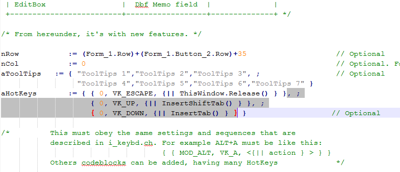

Function InputWindow()
Hola Angel, fijate como fué resolvido.
Pablo César wrote:
apais wrote:If you could also use the arrow keys up/down would be great !!
I'll see how to do it.
Very easy ! :D
Remember Angel, now you can add HotKeys assigning functions of each. And I've added this:
This changing behaviour, we have to take caution, specially for EditBox and proper behaviour but for the rest, is working Ok ! :D
Enjoy it !

Pablo César wrote:Dear Claudio,
Best Regards,
See Pablo:
Static Function xIfEmpty()
If Empty(This.Value)
StopControlEventProcedure (This.Name, '_InputWindow', .F.)
   SetProperty('_InputWindow',This.Name,'BackColor',RED)
   PlayBeep()
   hb_IdleSleep( 0.5 )
   nTypeButton = MB_ICONHAND + MB_OK   // (i_MsgBox.ch)
   x:= MessageBoxTimeout ("No empty field is allowed !", "Attention", nTypeButton, 3000)
   DoMethod('_InputWindow',This.Name,'SetFocus')
   SetProperty('_InputWindow',This.Name,'BackColor',WHITE)
StopControlEventProcedure (This.Name, '_InputWindow', .T.)
Endif
Thank you Claudio !
I have forgoten that need to be stopped all events and when calling MessageBoxTimeout without events interferences.
But something is interfering about colour of controls, stayed checkcolor in white backcolor and loose all events after first time MessageBoxTimeout is displayed at every empty/zero control. :o
B.Rgds.
