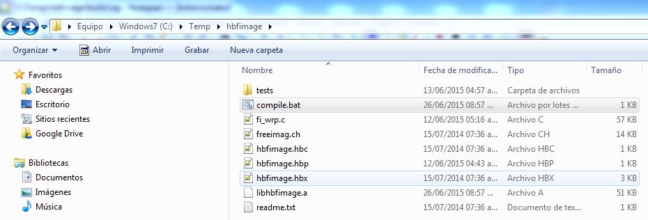

Post DATA :
El error que muestra es que falta un compilador en el PATH de HMGx, mientras tanto esto no ocurre ya que en harbour Nightly el compilador MinGW esta dentro del path.
corregi dicho batch y ahora compila con las distribuciones de HMG
The error it shows is that a compiler missing in the PATH HMGx, while this does not happen because in harbor Nightly MinGW compiler is within the path.
corrected and now this batch distributions compiled with HMG
WORKING :
cls
@echo off
set Backup=%path%
set HB_WITH_FREEIMAGE=C:\FreeImage\Dist\x32
rem *** use Harbour in HMG directory
set path=%path%;C:\hmg.3.4.0\HARBOUR\bin;C:\hmg.3.4.0\MINGW\bin
hbmk2 hbfimage.hbp
set path=%backup%
