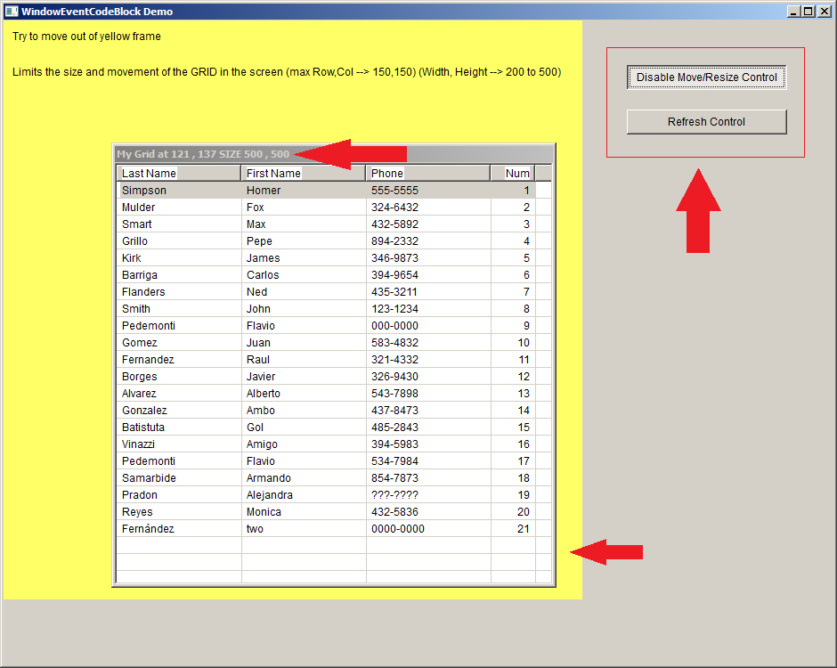

WindowEventCodeBlock
I wish to let it this adpated demo:
<Source code demo was removed, because there is an updated version more ahead of this topic>
<You an access this one: viewtopic.php?p=39957#p39957>
I changed HMG_ChangeWindowStyle (hWnd, WS_CAPTION + WS_SIZEBOX, NIL, .F., .T.) for:
HMG_ChangeWindowStyle (hWnd, WS_CAPTION + WS_THICKFRAME , NIL, .F., .T.)
I also changed:
  • Title in Grid frame with actual position.
  • Yellow frame ON Paint and labels to display a range in moving control.
  • InvalidateRect (GetParent (hWnd)) inside IF flag == .T.
  • Local variables and declare CONSTANTs at begining of code
  • Added buttons to Enable/Disable Move/Size control and refresh control
All merits to Claudio !

Re: WindowEventCodeBlock
Please test this version.
The syntax is:
nIndex := SetEventCodeBlock (hWnd, {|| ProcMoveSizeControl()}, NIL ) // Precess all messages
nIndex := SetEventCodeBlock (hWnd, {|| ProcMoveSizeControl()}, { WM_KEYUP, WM_SIZE, WM_WINDOWPOSCHANGED } ) // Precess only this list of messages
nIndex := SetEventCodeBlock (hWnd, {|| ProcMoveSizeControl()}, WM_WINDOWPOSCHANGED ) // Precess only this message
RemoveEventCodeBlock (nIndex)
