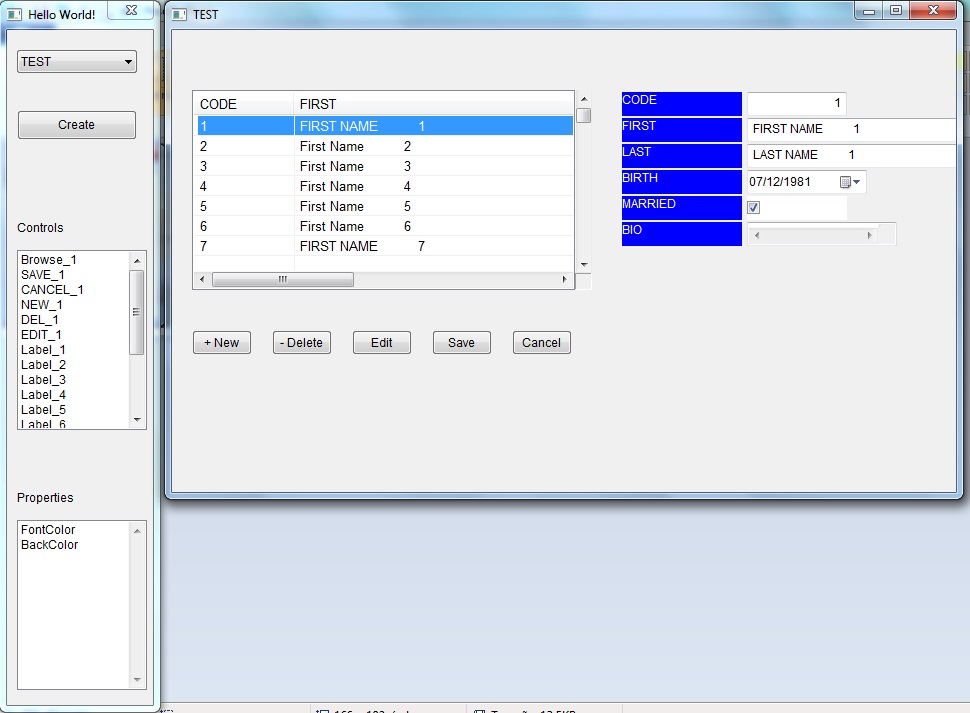

Hello Dragancesu,
I saw your example and I liked the way it fast and thought they could improve it and I thought making these changes, I hope not bother to modify your code!
First Step: Run the program.
Sedundo Step: Select the database.
Step Three: Surprise!
Fourth Step: Move F5 F9 Redimenciona control and control of the new window, enter the cursor over the control and press F5 or F9 and drag. You can also select a control in the Listbox_1 and then the property that is the lintbox_2 of the first window. Remember TimePicker and Button has BackColor or FontColor, if you do not give error. You can Resize the form.
Step Five: click the "Create" button
I hope you enjoy it !, it's a demo only. Any comments welcome!

Re: Quick Browse Form
Good thing you like Steed, I go !, upgrade just to improve the * .prg created!

Gragancesu,
Good thing you like!
Yes, you can make a report Choosing the fields that you want to print and give the width you want, I saw an example to print after a while you look for the league and the command to see if it helps.
Or as you imagine it would be?
Greetings.
