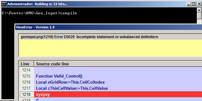

Hi All ! :D
I have been preparing (not 100% finnished) but the ViewError app is workable and works perfectly with this listed Build.bat below of our last HMG version released.
But I wish to clear something before. This use is optional, is not official use yet and I do not know if this it will be considered as part of HMG or not. Any way the use of it is for your own risk ( :lol: I'm kidding ).
It's good to read this before, please.

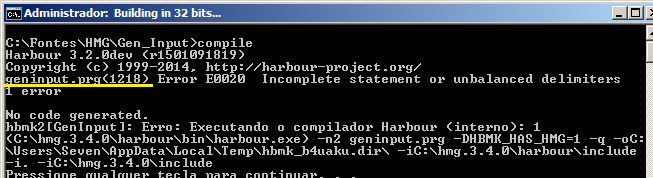

As you must know, ViewError is an app which helps to visualize the source code when happen an error at source code during build. This building can be by IDE or by prompt command. Some runtime errors and some errors which harbour could not identify by lines of source code, will not be display the source codes.
This is the Build.bat (Build64.bat can also be adapted), and it works in both ways (with ViewError app and without). Previously at this last HMG release (HMG 3.3.1 and older) when we tried to compile and the app was running, was displaying a non very well defined message to user giving an error. But now one message will be displaying saying that app must be closed before building.
Here in this topic you can find and access the newest version of Build.bat.
It was improved, revised and tested. This batch can work with follwing options:
Without ViewError app:
  • Run in IDE and thru Prompt Command
  • It will check if executable is running and give vbs message (MessageBox in VBScript)

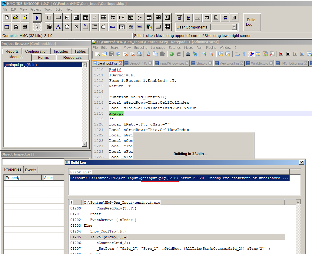

  • In case of error at IDE. IDE will display the error as ever done
  • In case an error at Prompt Command, will make TYPE and PAUSE
With ViewError app:

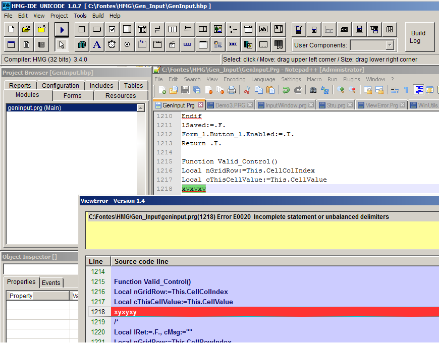

  • It will check if executable is running and give app message
  • In case of error at IDE. App will display the error showing source code at line in conflict
  • In case an error at Prompt Command, app will also display the error showing source code at line in conflict
This Build.bat, will check and take the variable ViewError at your enviroment variables system and see if is defined with folder or if it's empty one.
When is defined the path of ViewError, will execute it. But if is deleted (not find executable) will proceed without ViewError app on compiling procedure.
When you run for first time, ViewError check if this variable is setted or not. And will set the variable with the folder where ViewError is installed. The only problem that need to reboot to take effect of installation.
But you can test without any problem at all. If you do not want to reboot just to make tests, you can re-edit this Build.bat at line # 72 and put full path of ViewError is installed in you hard disk. ;)
When be completed/finnished the app will offer two ways to re-edit source codes when an error happen: one be done by the GRID and other by your favorite source Editor installed (using new HMG_GetFileAssociatedWithExtension function).

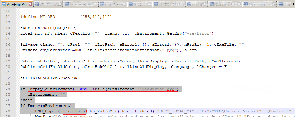

ViewError
There were a bug saying all the time to be installed and indicating to reboot your PC.
Have been fixed on these lines:
Note: Source codes and executable files were removed due there is a updated version more ahead for you downloading.
