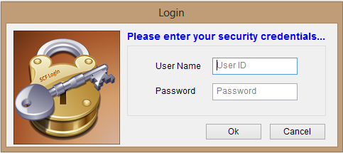

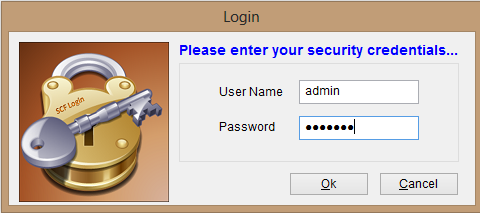

Hi Chang,
In addition to the contribs/samples posted above, here's another trick. This is the code snippet.
What it does?
The initial form display is shown on the .png attached file. Once the user began typing the TEXTBOX control txbPwd will become hidden and its initial or first character typed on it will be forwarded to txbPassword. At this point txbPassword will be shown and the keyboard buffer will be automatically put those remaining character typed by the user without any extra coding. It all happened in a fraction of a second.
The reason why you need some tricks is because once PASSWORD is defined with TEXTBOX control it is simply not readable and you can't changed it at runtime (as already mentioned in the posting above).
- This is the initial display
- pass.PNG (52.12 KiB) Viewed 5171 times
- This when the users typed on it
- pass1.PNG (54.06 KiB) Viewed 5172 times
