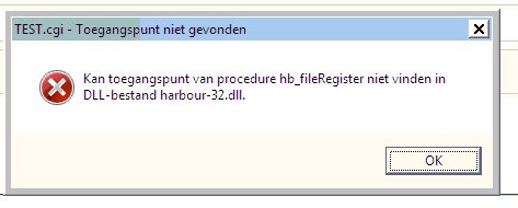

I did some tests with HMG/WEB Alpha 012 + NETIO.
HMG + NETIO works fine but combining with HMG/WEB Alpha 012 gives an runtime-error:
TEST.cgi - Entrypoint not found
Unable to find entrypoint of procedure hb_fileRegister in DLL-file harbour-32.dll
What I did:
1) HMG app with NETIO (See Connect_NetServer() and USERSDBF()... : works OK
2) Server application with several queries (see Q_USERS()) which are called from HMG app: works OK
3) Index.html with TEST.CGI which calls also Server-app-query Q_USERS: gives runtime-error.
4) Index.html with TEST.CGI which has a copy of Q_USERS: works OK.
So I can't get NETIO working with CGI. Harbour-32.dll is located in the same folder as the CGI modules.
Any idea how to fix this?

SERVER Function
/* Q_USERS is located within HMGSERVERIO.PRG                             */
/* When calling netio_funcexec( 'Q_USERS', '' ) from a HMG Application   */
/* (function USERSDBF) this works fine.                                  */
/* When calling from TEST.CGI it gives a runtime-error:                  */
/* TEST.cgi - Entrypoint not found                                       */
/* Unable to find entrypoint of procedure hb_fileRegister in DLL-file    */
/* harbour-32.dll.                                                       */
/* (see att.  )                                                          */

serge_girard wrote:Roberto,
I can't help, since I've not tested NETIO on a CGI app.
Anyway... maybe in real world conditions, you should not need that.
At least in my case, the dbf files are located in the same machine as the web server, son your cgi apps, does not need to communicate with dbf files via NETIO. You should follow that path, since is the most simple and efficient.
