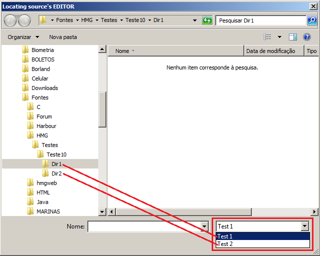

What I mean, changing codes to accept the 3rd parameter as array, it will be posible to have more than one default folder. Because it will be displayed and positioned at each case of 1st parameter. In other words:
If I have this {{'Text files', '*.txt'}, {'RTF files', '*.rtf}} as 1st parameter and be posible to have the 3rd parameter as an array like this: {"C:\My documents\Text files\","C:\My documents\Rich files\"} then for each element I could have different folder to be displayed/positioned.
Windows does not easily allow you to do this. The HMG function GetFile() is basically a shell for the Windows function GetOpenFileName(), which uses the Windows OPENFILENAME structure. This structure does not allow the default folder to be an array, just a scalar value. In order to implement your suggestion, someone would have to write a variant of GetOpenFileName() out of more primitive components. That's a pretty big piece of C programming, and it's not worth it to me.

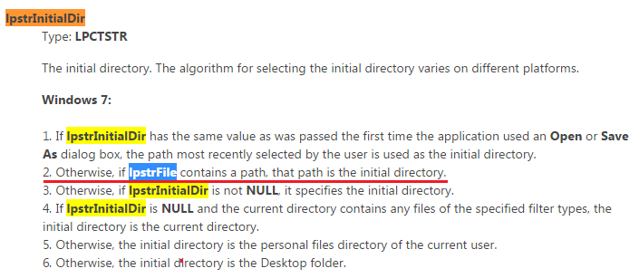

kcarmody wrote:Windows does not easily allow you to do this. The HMG function GetFile() is basically a shell for the Windows function GetOpenFileName(), which uses the Windows OPENFILENAME structure. This structure does not allow the default folder to be an array, just a scalar value. In order to implement your suggestion, someone would have to write a variant of GetOpenFileName() out of more primitive components. That's a pretty big piece of C programming, and it's not worth it to me.
Thank you for your suggestion, but is not is not feasible. The strange that I read this:
http://msdn.microsoft.com/en-us/library ... 85%29.aspx
But I tested in Win7 and when the 3rd parameter is not informed not assume that. :(

Pablo César wrote:The strange that I read this:
I don't know what you mean by "strange that I read this" or "3rd parameter is not informed not assume that". The text you quote, which is MSDN documentation for the default folder parameter, does not state or imply that this parameter can be an array. That is why your suggestion is not feasible.
Strange because something should be work about remarked line. MSDN was not extended to explian how it do this. But as you said, doesn't means that it could be used an array even I understanding that lpstrFile is being created as ARRAY from buffer at C:\hmg.3.3.1\SOURCE\c_dialogs.c in C_GETFILE function. Sorry if I am wrong, but for me lpstrFile is passed as array, doesn't it ? If it is, why MSDN would not use it ? I ask this for myself, of course all is hipothetic and wonderful to have it for better results. It is just a wish Kevin.
lpstrFile is not an array but a null-delimited list of path names. This list is converted to a Harbour array if it contains more than one path name.
More technically, lpstrFile is a pointer to a string called buffer. Note the initialization of buffer on line 170:

Enhancements to GetFile() and PutFile()
Thank you again Kevin for your clarifications about lpstrFile and you are right to say that GetOpenFileName take a top of this list (first element) it what I already supposed to be. This same folder name would it be changable accordingly full path passed from lpstrFile. Probably in the future subject to goodwill of MSDN to implement it. Imagine to choose the each type of file and positioning at the expected folder in each item.
Like this:
Once again thank you for your comments and patient.
