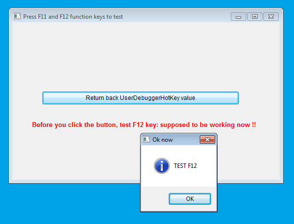

Colleague Kek (tiampei) mentioned how to enable F12 on Windows in: http://muzso.hu/2011/12/13/setting-f12- ... in-windows
I have adapted the Theo example code with LOG alteration and it works! :D

However, when you change the UserDebuggerHotKey key in the registry, you disable AeDebug (This is not a big loss for common user because it is used in execeptional and high level of MSDN development, I guessed). And it is critical that the machine must be rebooted after changing the registry for taking effect in the change.
This following captured screen was taken after boot. It Works !! :P

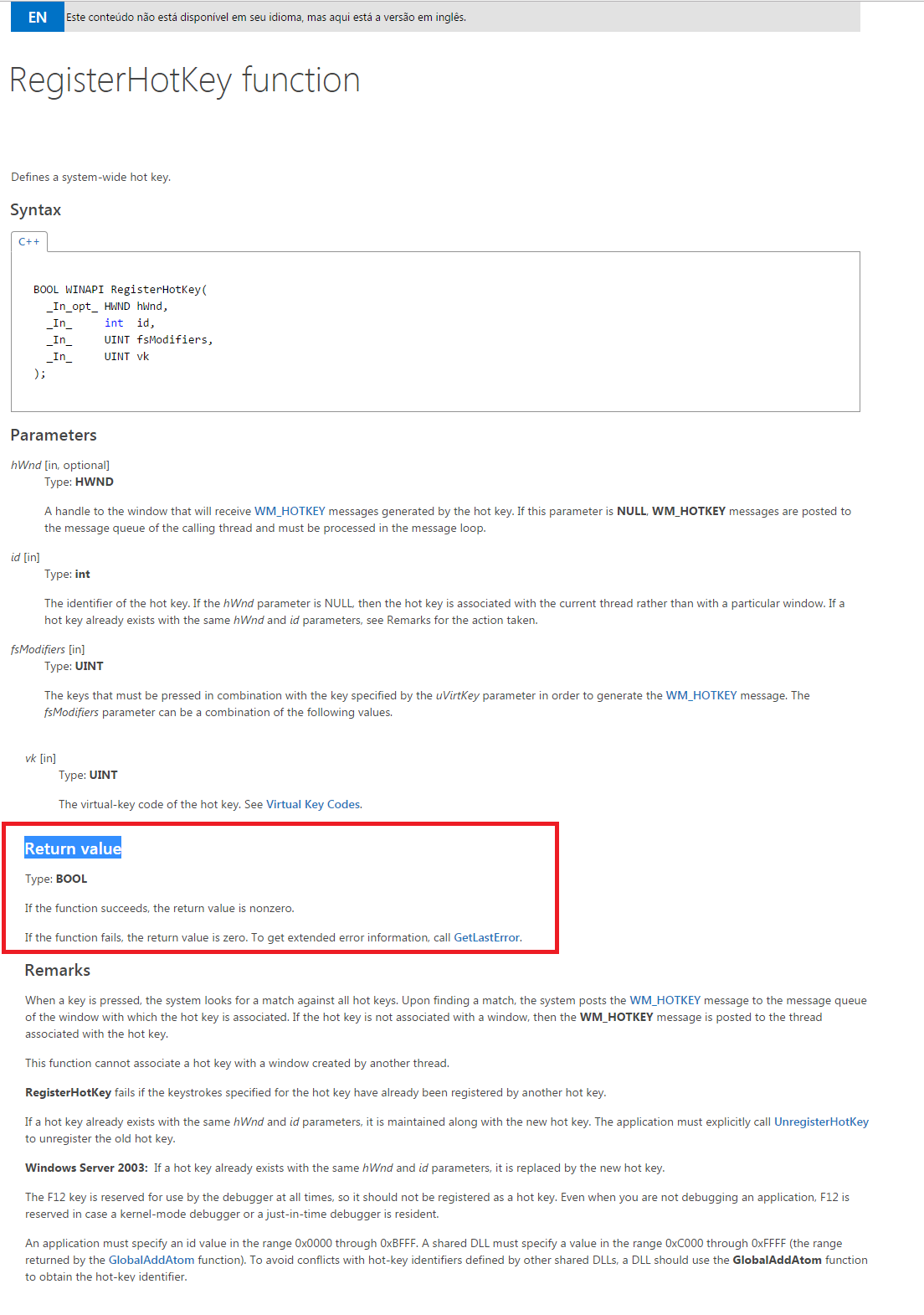

There is a interesting point that according MSDN saying that RegisterHotKey function can returns a value when is succeeds or not...
I think if our _DefineHotKey can be able to return value if success or not, it would helps. :?
I do not know in C if is this correct ?

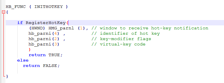

Pablo César wrote: Sun Mar 12, 2017 7:20 pm I do not know in C if is this correct ?
I think in this way will be better:

KDJ wrote: Sun Mar 12, 2017 8:53 pm It is a little uncomfortable because you have to restart your machine.
Yes: it is uncomfortable to have to boot at least once. But also if there is so much need to enable this particular F12 key (taking into account so many others and their combinations) that perhaps it is worth doing this.
It's only one time at least that is needing to boot ...
KDJ wrote: Sun Mar 12, 2017 8:53 pmI think in this way will be better:
HB_FUNC ( INITHOTKEY )
  hb_retl(RegisterHotKey(
            (HWND) HMG_parnl(1), // window to receive hot-key notification
            hb_parni(4),         // identifier of hot key
            hb_parni(2),         // key-modifier flags
            hb_parni(3)          // virtual-key code
Thank you Krzysztof. Now in my sample, it is working perfectly and with unsure when is able to register or when not.
I think _DefineHotKey in HMG could it be done like that. It's good to know the return value, specially for this case.
