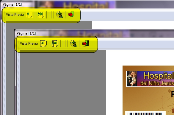

Re: HMG.3.3.0 Patch 3 (32 and 64-bits)
Hola
vuelve a salir así:
Alguna idea ?
Apply the Patch 3, ran the "BuildAllLib.bat" and try the print Preview
reappears as follows:
Any idea?
Aplique el Patch 3, corri el "BuildAllLib.bat" y al probar, el Preview de impresiónHi all.
This patch include the previous patch 1 and 2. viewtopic.php?f=43&t=3782" onclick="window.open(this.href);return false;" onclick="window.open(this.href);return false;
Unzip the patch in c:\hmg.3.3.0\ and execute BuildAllLib.bat and _BuildAllLib64.bat
Please you check for changes made.
vuelve a salir así:
Alguna idea ?
Any idea?
- HMG Patch3-1.jpg (105.61 KiB) Viewed 20957 times

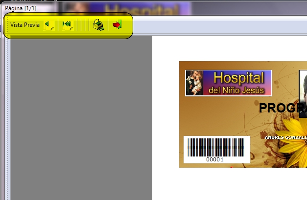

Tome el directorio RESOURCES del archivo HMG-32bits.3.3.0_Patch.zip
y se ve mejor la imagen pero siguen sin aparecer varios iconos...
Take the RESOURCES file directory HMG-32bits.3.3.0_Patch.zip
and the picture looks better but still missing several icons ...
- HMG Patch3-2.jpg (104.46 KiB) Viewed 20955 times

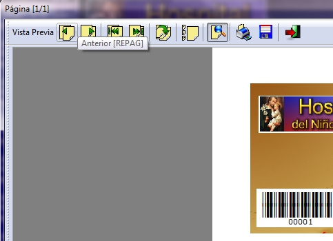

This patch you applied?andyglezl wrote:Hola
This patch include the previous patch 1 and 2. viewtopic.php?f=43&t=3782" onclick="window.open(this.href);return false;" onclick="window.open(this.href);return false;" onclick="window.open(this.href);return false;
vuelve a salir así:
Alguna idea ?
Any idea?
download/file.php?id=4785
Is very rare, the image you posted is the toolbar uncorrected (without applying the patch).
Hi Andyglez:
Use - as Claudio said - PATCH 3.-
When you rebuild libraries, first choose option 1 (ansi), then rebuilt procedure finish, rebuild libraries again, and this time choose option 2 (UNICODE).-
I've use this method and PATCH 3 works fine.-
This is just a proposal-
With regards.
Eduardo
With regards.
Eduardo
No se que pasó, aplique de nuevo el c_toolbar.c y ya quedo...
viewtopic.php?f=43&t=3761&hilit=c_toolbar&start=20Sorry friends,
please copy the attachment (c_toolbar.c) in c:\HMG.3.3.0\SOURCE
and run BuildAllLib.bat and _BuildAllLib64.bat
c_toolbar.rar [3.98 KiB]
Downloaded 71 times
- HMG Patch3-3.jpg (75.76 KiB) Viewed 20926 times

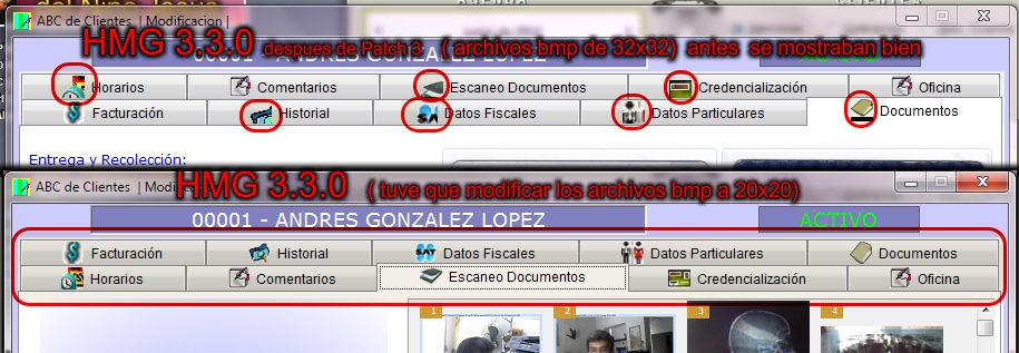

Al parecer si hubo cambios en el manejo de los archivos bmp, ya que anteriormente
manejaba unas imágenes en un TAB y se mostraban bien, después del patch 3, se
distorsionan.
Tuve que modificar su tamaño para que se mostraran bien de nuevo.
Apparently if there were changes in the management of bmp files as above
handled some images on a TAB and showed well after patch 3 is
distorted.
I had to resize it to be shown again either.
distorsionan.
distorted.
- HMG Patch3-4.jpg (262.81 KiB) Viewed 20910 times
