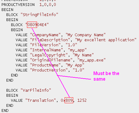

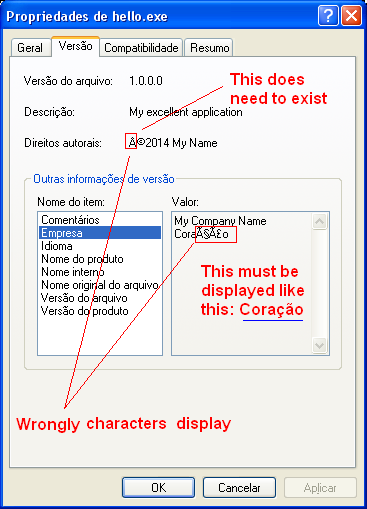

Dear Claudio,
Probably you may help us in this. I have got good results with windres script but when I try to write any string with local accents (portuguese: çÇãÃôÔáÁéÉíÍóÓúÚ) and also this "©" UNICODE character it seems .rc file must be in ANSI because as following display:
Searching the internet, I found windres.h special file for UNICODE.
So, this our WindRes.exe is it in UNICODE or in ANSI mode ? Shall it be differentiated according it compiling mode ? Because, our rc file is been written in UTF-8 without BOM and probably this must kept in ANSI mode or shall be the right WindRes for UNICODE/ANSI. What do you think my friend ?
FYI, I setted to portuguese for langID code and I also tried for UNICODE for charsetID but not successful. :(
Even following:
For further details (language.. etc), please read these:
WindRes for MinGW
MSDN definitions

Hi Pablo
You're Always right. It works perefctly.
If you use the ".RC" file, you cannot use anymore the "-icon=iconfile.ico" option but you need to include the icon resource inside the resource (.rc) file.
Thank you very much to share your knowledge.
Vieri

It's strange, but when I change translation from U.S. British to Polish:
before:
BLOCK "VarFileInfo"
  BEGIN
    VALUE "Translation", 0x809, 1252
  END
after:
 BLOCK "VarFileInfo"
  BEGIN
    VALUE "Translation", 0x415, 1250
  END
some properties like LegalCopyright, ProductName are missing in .exe file properties.

Hi Marek,
When you need to change the language, you need to change in two places: the langID and charsetID because if anything doesn't match then will not work properly.
I have found trouble with UNICODE characters, so I do not know if going to work properlly the values when any language accent be typed.
