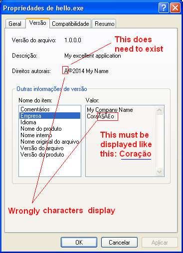

Dear Claudio,
Probably you may help us in this. I have got good results with windres script but when I try to write any string with local accents (portuguese: çÇãÃôÔáÁéÉíÍóÓúÚ) and also this "©" UNICODE character it seems .rc file must be in ANSI because as following display:
Searching the internet, I found windres.h special file for UNICODE.
So, this our WindRes.exe is it in UNICODE or in ANSI mode ? Shall it be differentiated according it compiling mode ? Because, our rc file is been written in UTF-8 without BOM and probably this must kept in ANSI mode or shall be the right WindRes for UNICODE/ANSI. What do you think my friend ?
FYI, I setted to portuguese for langID code and I also tried for UNICODE for charsetID but not successful. :(
Even following:

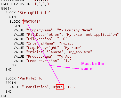

Hi Marek,
When you need to change the language, you need to change in two places: the langID and charsetID because if anything doesn't match then will not work properly.
I have found trouble with UNICODE characters, so I do not know if going to work properlly the values when any language accent be typed.
