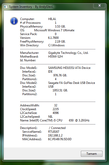

Hi friends,
please don't worry ;)
Here working version of sample sent by Andrés ( from here )
System Inventory by Andres Gonzales
SysInvent.zip
System Inventory by Andrés Gonzales
(1.96 KiB) Downloaded 465 times
... and, once again,
Viva HMG :D

Thanks Mr. Esgici,
Now run smoothly!
