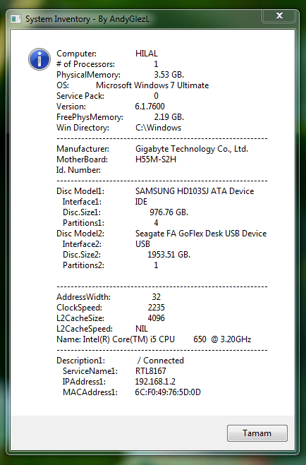

I'm talking about this code posted by Andy before. I'm sorry, Serge, I didn't checked the attached IS.rar (I assumed that the source code is included). Anyway if you try the first SysInvent from the linked topic above, you will find the same problem and it will be the same solution or the one recommended by Mr. Esgici.

Hi friends,
please don't worry
Here working version of sample sent by Andrés ( from here )
... and, once again,
Viva HMG
please don't worry
Viva HMG

Thanks Mr. Esgici,
Now run smoothly!
Now run smoothly!
