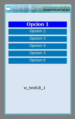

Re: Control under the Mouse
Hola
Aqui les dejo una variante del ejemplo de jpp y Pablo Cesar.
Hello
Here 'example of a variant of jpp and Pablo Cesar.
Hello
#define BLUE1 { 218,229,243 }
#define BLUE2 { 000,120,187 }
STATIC cCtrlAnt:="", lProp:=.F.
DEFINE WINDOW w_test AT 000 , 000 WIDTH 230 HEIGHT 380 BACKCOLOR BLUE1 TITLE "SIMULATE A MOUSE OVER --- BY AGL" MAIN
ON KEY ESCAPE ACTION Thiswindow.Release()
@ 030,010 LABEL LB_1 VALUE "Opcion 1" OF w_test WIDTH 200 HEIGHT 20 FONT 'Verdana' SIZE 9 FONTCOLOR WHITE BACKCOLOR BLUE2 CENTERALIGN ACTION MsgInfo( "Opcion 1" )
@ 055,010 LABEL LB_2 VALUE "Opcion 2" OF w_test WIDTH 200 HEIGHT 20 FONT 'Verdana' SIZE 9 FONTCOLOR WHITE BACKCOLOR BLUE2 CENTERALIGN ACTION MsgInfo( "Opcion 2" )
@ 080,010 LABEL LB_3 VALUE "Opcion 3" OF w_test WIDTH 200 HEIGHT 20 FONT 'Verdana' SIZE 9 FONTCOLOR WHITE BACKCOLOR BLUE2 CENTERALIGN ACTION MsgInfo( "Opcion 3" )
@ 105,010 LABEL LB_4 VALUE "Opcion 4" OF w_test WIDTH 200 HEIGHT 20 FONT 'Verdana' SIZE 9 FONTCOLOR WHITE BACKCOLOR BLUE2 CENTERALIGN ACTION MsgInfo( "Opcion 4" )
@ 130,010 LABEL LB_5 VALUE "Opcion 5" OF w_test WIDTH 200 HEIGHT 20 FONT 'Verdana' SIZE 9 FONTCOLOR WHITE BACKCOLOR BLUE2 CENTERALIGN ACTION MsgInfo( "Opcion 5" )
@ 155,010 LABEL LB_6 VALUE "Opcion 6" OF w_test WIDTH 200 HEIGHT 20 FONT 'Verdana' SIZE 9 FONTCOLOR WHITE BACKCOLOR BLUE2 CENTERALIGN ACTION MsgInfo( "Opcion 6" )
@ 250,000 LABEL LB_7 VALUE "" WIDTH 200 HEIGHT 20 FONT 'Verdana' SIZE 9 FONTCOLOR BLACK CENTERALIGN TRANSPARENT
CREATE EVENT PROCNAME SELECTCTRL( EventWPARAM() ) // HWND W_test.HANDLE
CENTER WINDOW w_test
ACTIVATE WINDOW w_test
RETURN Nil
FUNCTION SelectCtrl( wParam )
LOCAL cCtrl, cForm, cTemp
GetControlNameByHandle( wParam, @cCtrl, @cForm )
cTemp:=ALLTRIM( cForm )+ALLTRIM( cCtrl )
w_test.LB_7.VALUE := cTemp // **** Display cForn, cCtrl
IF cTemp==cForm
IF lProp
// La intencion es hacer que la Funcion acepte cualquier nombre de Ventana, pero de esta forma no se ejecuta el ACTION del LABEL !
// The intention is to make the function accepts any window name, but this way the ACTION of LABEL is not running!
*SETPROPERTY( cForm, cCtrlAnt, "FONTBOLD" , .F. )
*SETPROPERTY( cForm, cCtrlAnt, "FONTSIZE" , 9 )
*SETPROPERTY( cForm, cCtrlAnt, "BACKCOLOR", BLUE2 )
w_test.&cCtrlAnt..FONTBOLD := .F.
w_test.&cCtrlAnt..FONTSIZE := 9
w_test.&cCtrlAnt..BACKCOLOR := BLUE2
lProp:=.F.
IF ! empty(cCtrl)
IF ! lProp
w_test.&cCtrl..FONTBOLD := .T.
w_test.&cCtrl..FONTSIZE := 12
w_test.&cCtrl..BACKCOLOR := BLUE
cCtrlAnt:=cCtrl
lProp:=.T.
RETURN Nil- Attachments

Muy buen ejemplo Andrés!!!
Espectacular Andres, gracias por compartir.
